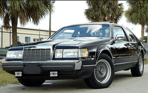

I liked the LSC, would be really great with a 347 stroker
Heheh, that's funny 'cause I think the Mark VII is one of the few cars that would be worth banishment to the far-out parking spaces at Chrysler's Tech Center. A favorite since the first time I cruised Gratiot in a friend's-dad's FoMoCo lease in '91. The ideal Fox body for those who hate Mustangs.
Absolutely. I've had 2 of them, and while not trouble-free, both were 20+ years old when I had them, with 125-150k miles (and not creampuffs, either). Easy to modify a little bit with Mustang parts, 20-23mpg depending on how you drive, and will run with a stockish 383 C-body give-or-take (a 4-barrel with 3.23 gears, that is, a 383-2 Newport with 2.76 gears is gonna get left behind).
And like the Imp, these would probably wake up a lot just with gearing work - a 4R70 trans (deeper gear ratios) from a 2WD 5.0 Explorer and a 3.73 axle. Could still be a granny car - just one that moves out in a big silent hurry.
