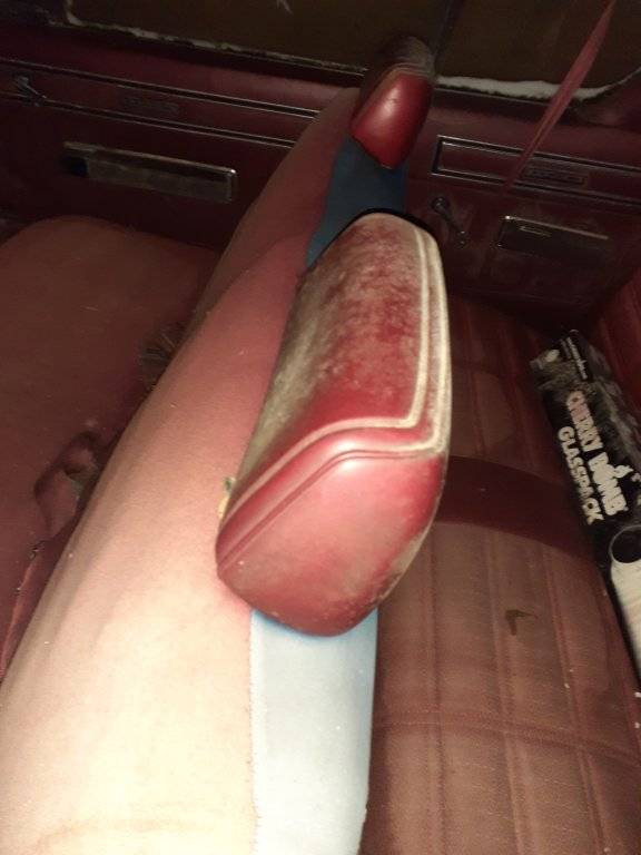

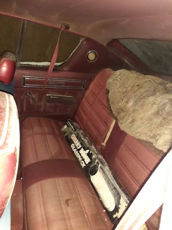

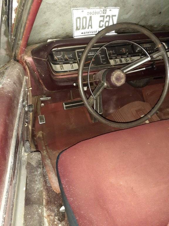

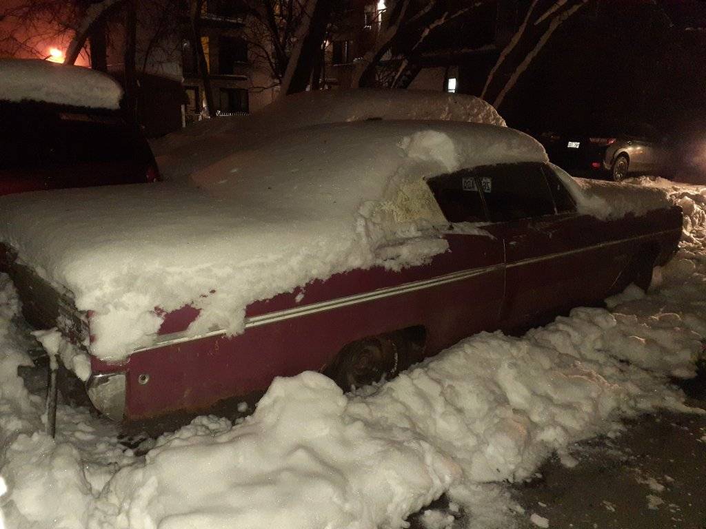

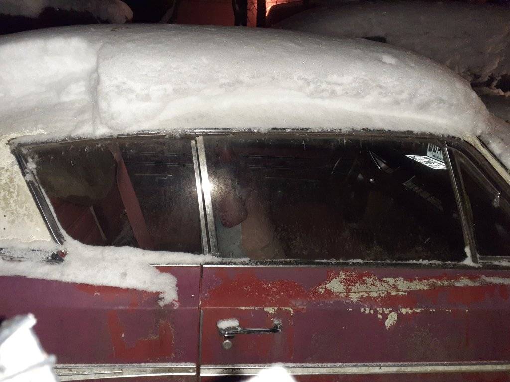

A contact of mine wanted me to check on the car , an old man bought it from yukon and had it back to Montréal 25 years ago , the car didnt run in the last 10 years, but had a new 904 , new windshield, some leaf springs job bla bla , 1968 fury 3 , fast top model , 318 230hp v8 , 2 door...hes asking 2k But will let it go for 1500$ , heard that theres no parts for the body , is it worth it ? The price is very cheap if you ask me , but from driving a duster to a 68 fury ? Must be pretty different ! * interior looks nice, sorry for the snow ( not the best pics ) i have a 69 valiant project that ill need to put aside if i buy this fury..

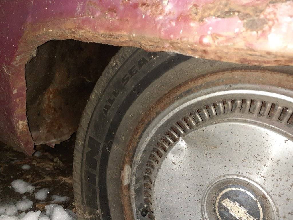

I see quite a bit of rust underneath -- how's the frame etc.?
Unfortunately i dont know but for 1500 its all there , sold as is and its all complete, same owner for the last 40 years

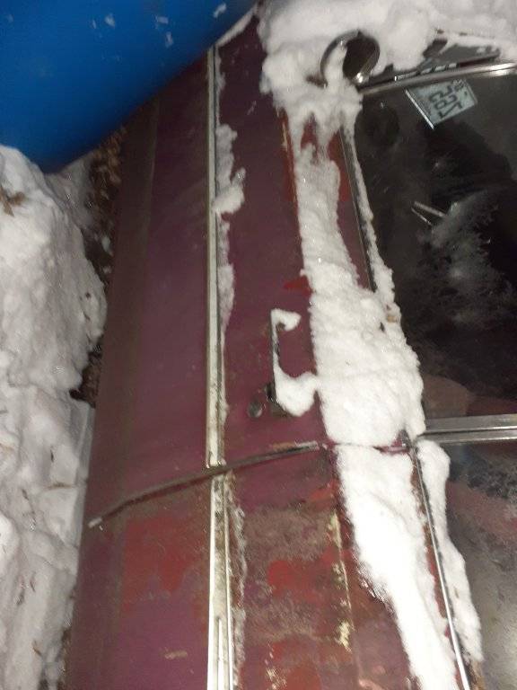

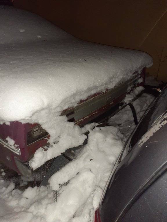

The fastops are famous for rotting out the bottom of back window and trunk.
I strongly recommend having a deeper look before you drop coin on it even if it is cheap.
Also check the frame rails front and back.
Welcome! In my opinion, for the money you couldn’t go too wrong.
That being said, I would sure want to look it over darn good. And I mean getting under it and check the rails front and back. Like you said, it’s all there. That means the bad too.
If it’s too far gone you could part it out maybe and recoup your money, but do you want to restore a car or run a junkyard business?
Good luck!

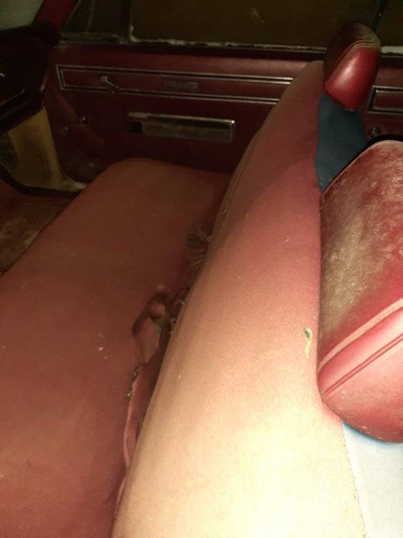

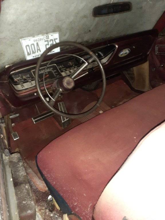

What is wierd about the interior is has VIP door panels. Power bench seat with headrests.
Car comes from the Yukon ! Same owner for the last 40 years , its all factory he only did maintenance job on it , factory red paint underneath the ugly dark red. ( so its a Fury 3 with vip options ? )* maybe different since it was a canadian car ?

The condition of that car from what we can tell from pictures that look like they were taken after an avalanche doesn’t look like a prize by a long shot.

I've owned a few examples of A, B, E and C bodies and the C-body cars are a little different. First, you aren't going to be able to buy everything from a catalog to restore the car, so it's pretty much used parts. C-bodies also rust differently than an A or B body. Let's say this was a '68 Dart instead of a Fury. You'd walk up to the Dart and immediately see rust holes in the fenders and quarters. The underside may or may not be good, but that gives you some indication of what's going on. With the C-body, the outside of the car could look a little crusty and the underside is just gone... Floors could be rotted through and it's not unusual to see rotted frame rails in the rear and the stub frame in the front could also be rotted.

Typical front fender rust in, let's say, a '70 Duster, is easy to spot. About 6" from the front on the top, about 12" from the rear on the front and side and then the bottom behind the wheel well. Reason? No inner wheel wells! The C-body has them and that prevents all but the bottom behind the wheel well. Rear quarters are built the same, but the C-bodies don't quite rust as bad.
The big news is the front stub frame. The battery sometimes will drip down through the tray and into the left frame rail. That shows up in some cars, but I think they just weren't designed to last 50+ years and they don't drain correctly. Good news is that they interchange within the lines easily, with some exceptions.. The rear frame rails rust just like the rest though.
