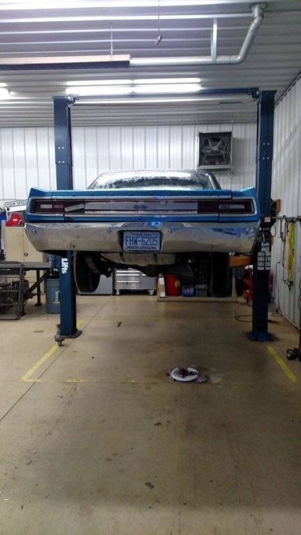

We have a lift at work. I waited till everyone was gone for the day. Ran the car up, reset the seal and lock ring. No more leaks.
