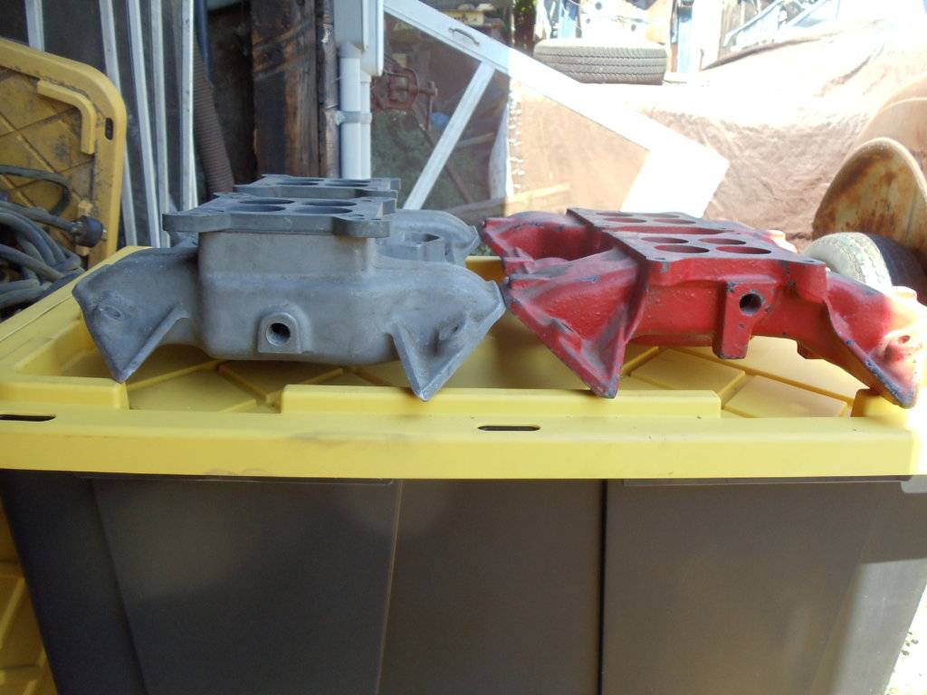

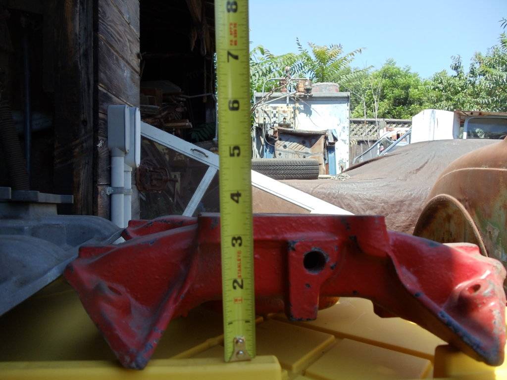

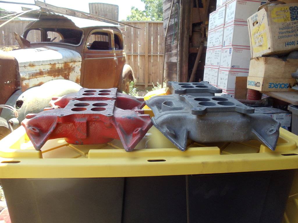

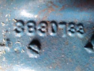

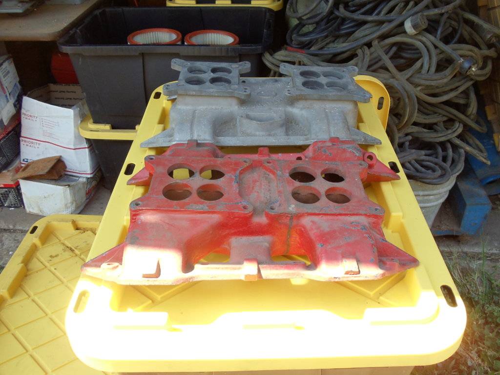

Looking at 2 intakes.. 1/ date code 6 26 69 #2951736
2/ Casting # 3830733
Both are 4 barrel intakes,, will they both fit on a mid 60s 383 and what would be considered a fair purchase price I,m looking at buying both,,, Dave (Catfish) Pic to Follow

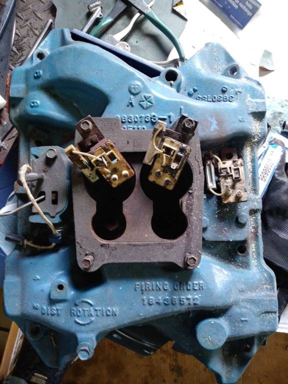

The '69 manifold has the longer intake runners for the open chamber heads. That would be my first choice. A lot of these were discarded for after market aluminum manifolds, so they are a not a hot collector item, see lots of them at swap meets etc for $35-$50. 3830733 is a 440 intake for '75-'76 and will not fit a 383 and is also set up for the thermoquad carb. Pass on that one unless you are doing a restoration on a '75-'76 440.
Dave
Member 413 is correct that manifold is also 440, 70-71 with Holley 4BBL on a C-Body.
Dave
Well, with a 440 LP C-body it will have a Holley, A 440 HP B C E body will have a carter AVS. Change the choke and it will fit either carb.

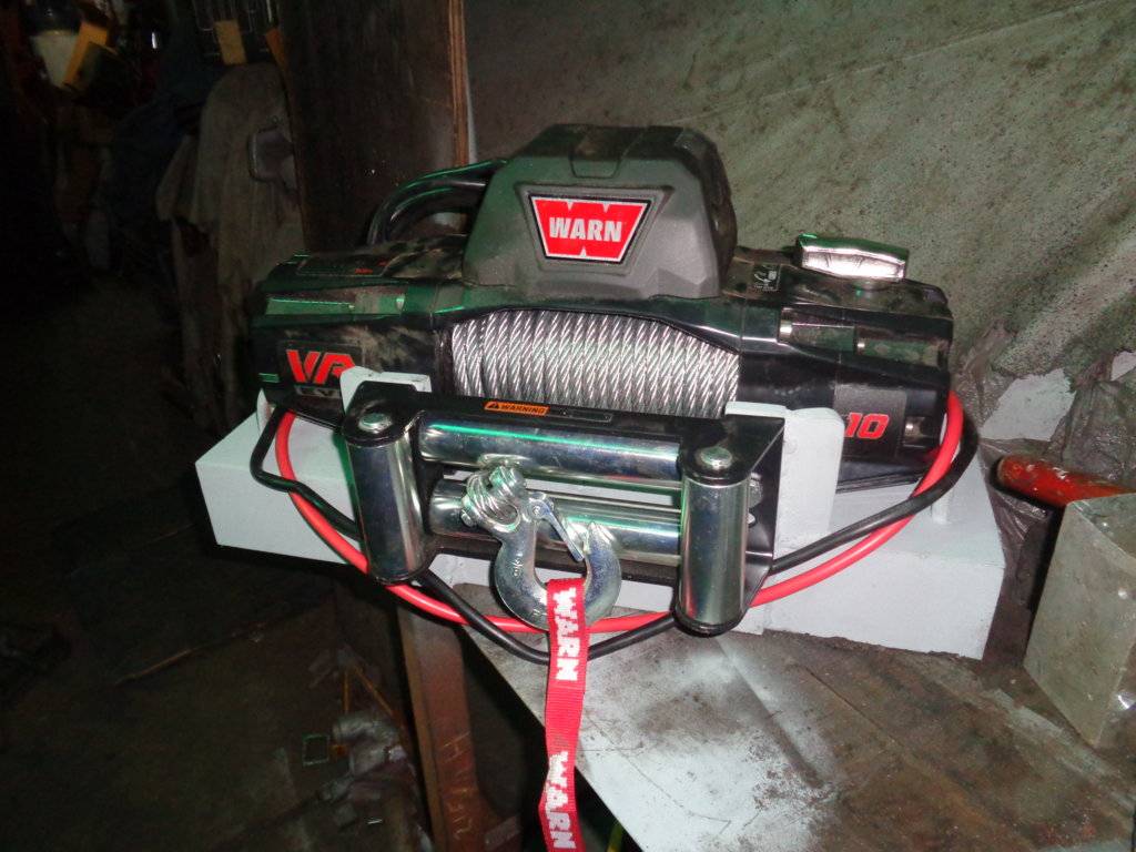

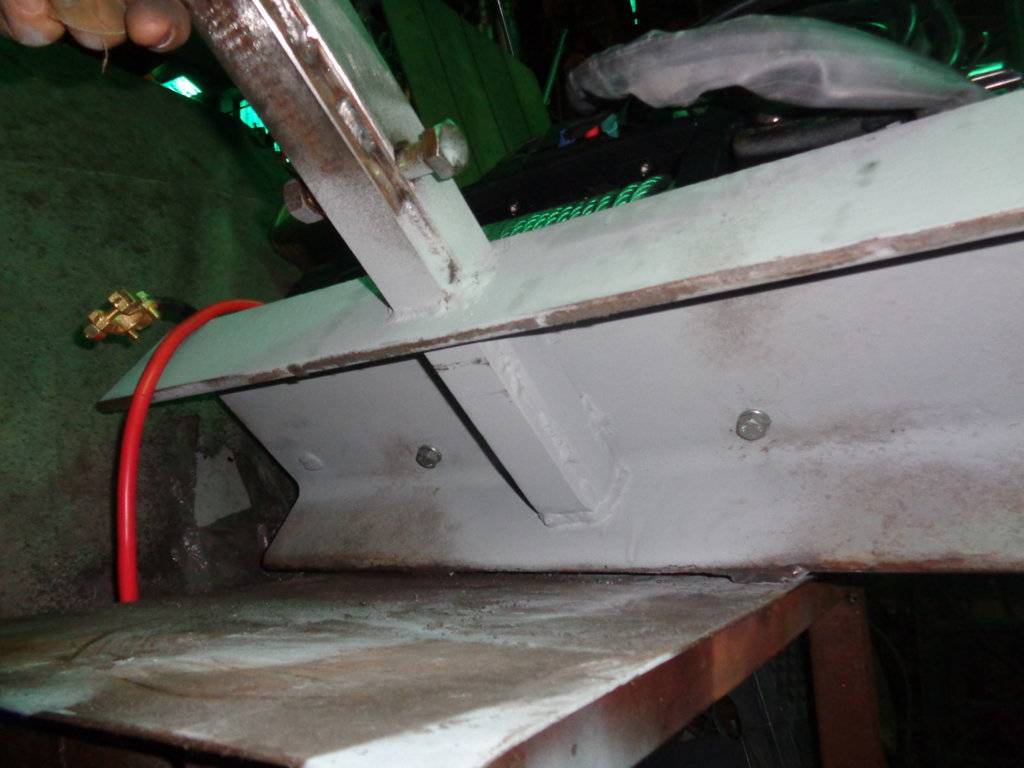

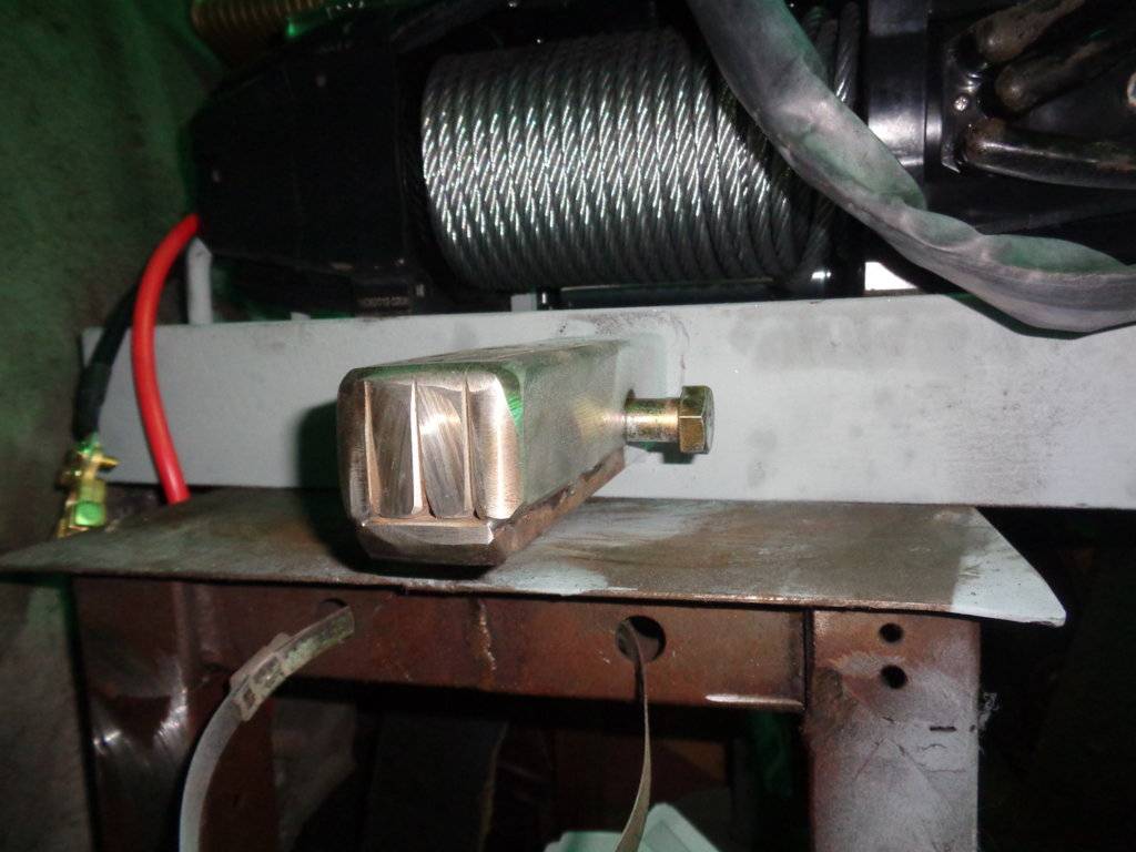

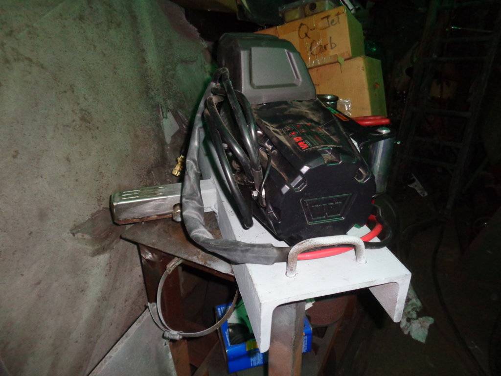

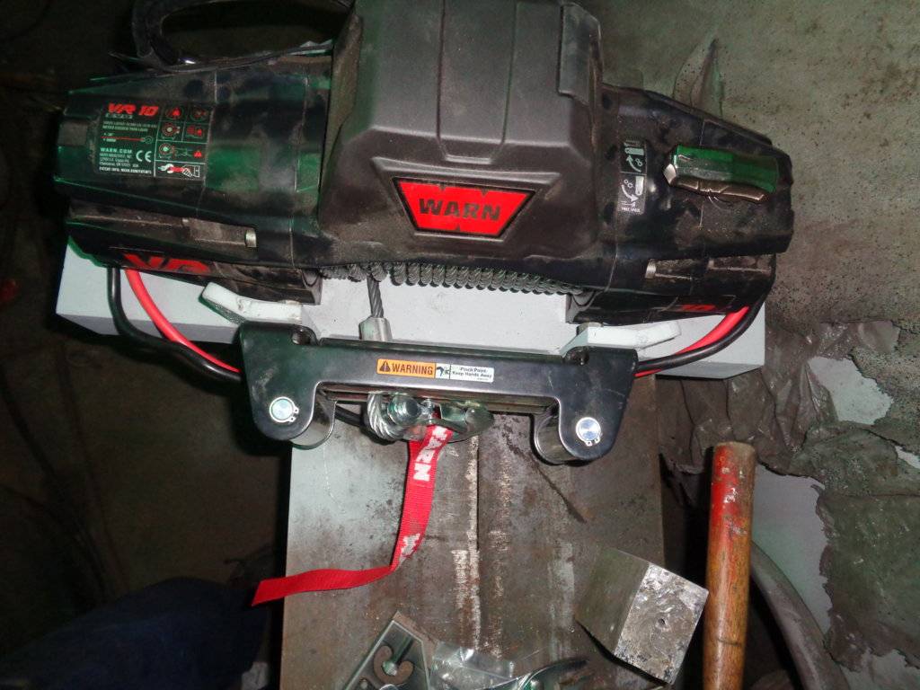

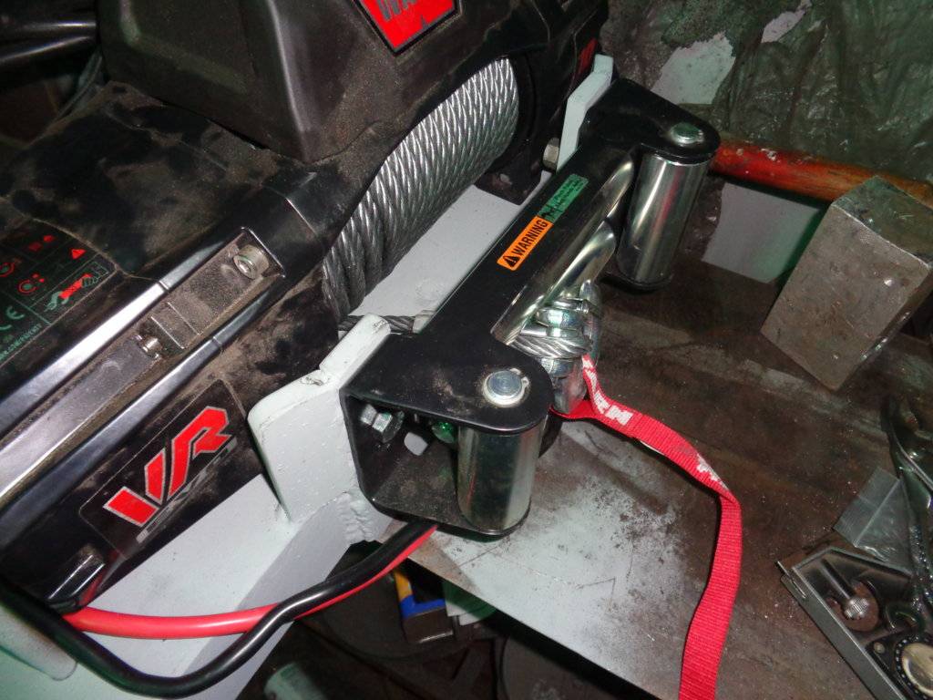

just got done with this tool build , i needed a way to pull some vehicles around in my yard , and this means hours of come a long time . so to speed up this process , i built a 10k winch mount for my hitch receiver on my p/u . its h/d 8'' 1/4 channel 1/2 web 1 1/2 x 1/2 bar stock , the stringer is 4 bar stocks welded together then plug welded and full round welded to that channel . what do you think ?
Sturdy engineering! I'd envy you if I had the resources for some of that stuff. I spend most of my energy on my little spawn at present, which keeps me out of trouble.......
