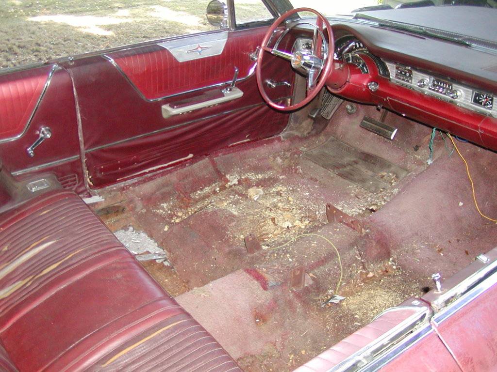

Picture 1 is from 2003. The faded pink mess is the original carpet that came with the car. If you look closely, you can see that the carpet (along with the floor!) is missing behind the drivers seat. After patching the floor, this was replaced with black carpeting from a New Yorker. Better condition, but still 40 years old.

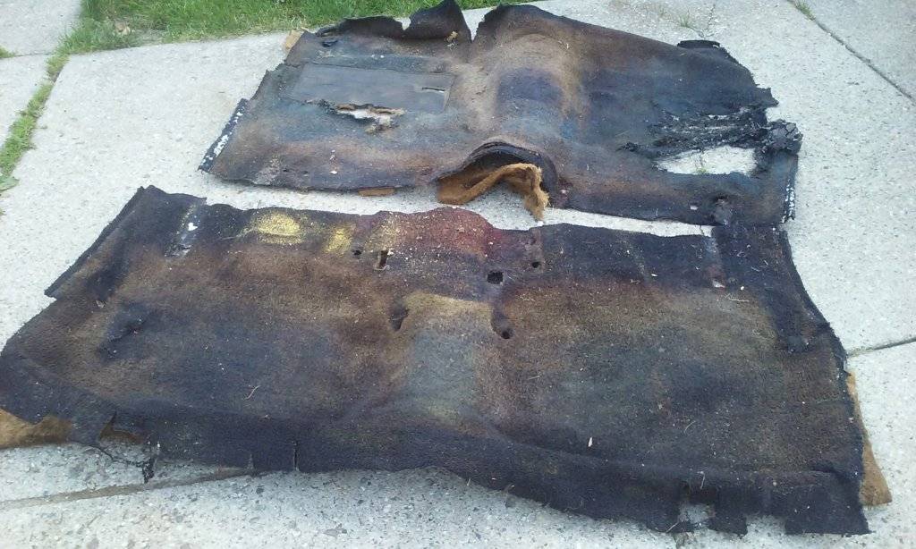

After another 15 years, this is what was left of the black carpet.
