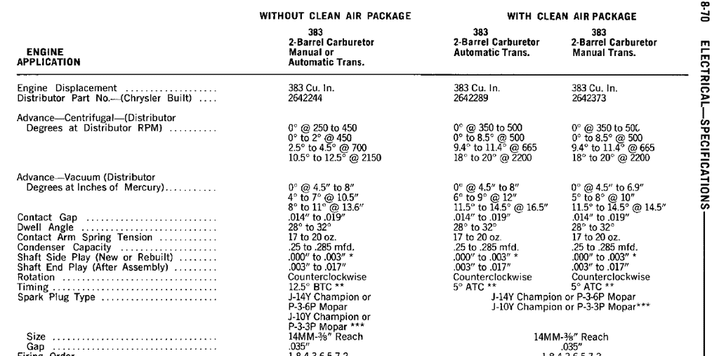

You sure you don't have the Champion spark plug numbers turned around? I THINK the J-10Y is for the 2 barrel motors, with the J-14Y for the 4bbl. Dig this! I inherited some J-11Ys with some old heads I scored locally this summer...
Look at P 8-70 of the FSM for the 2bbl:
