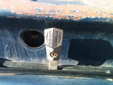

As far I know, it should look like this, from a wagon I looked at in the spring.

That looks right. The release lever has a hole for the screw. Missing on the Admiral.
That should be interesting to track down.

(The part number is 2935604 and it fits 1969-1973 C bodys)
