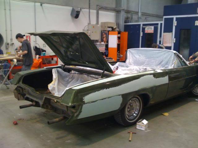

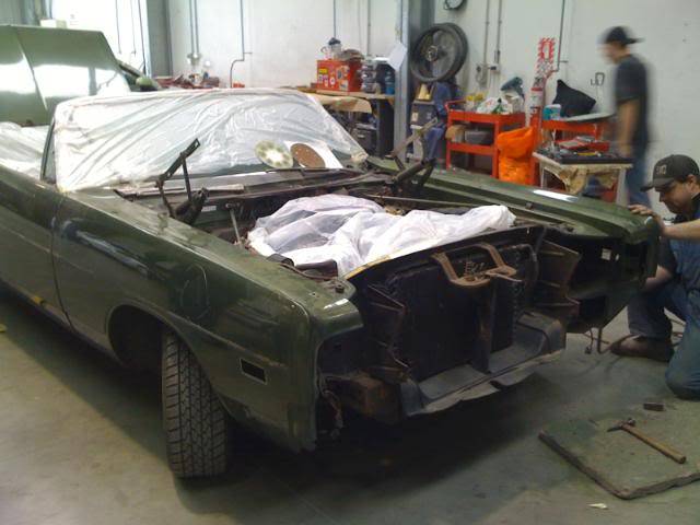

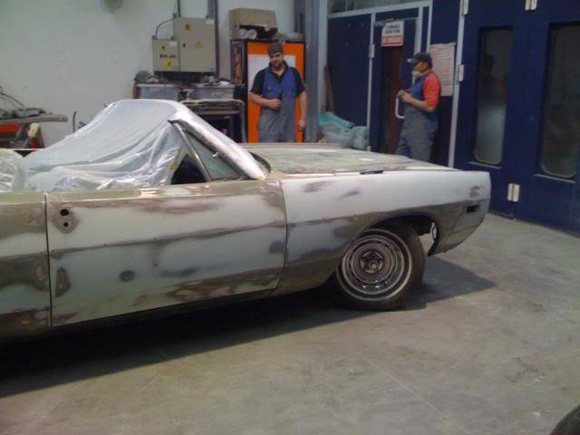

We had a 7.1 earthquake her in Christchurch New Zealand on September the 4th this year and my Car got damaged by falling tools etc in my garage,
I had a Mopar show to go to on the 22nd of October and the Insurance company gave us the ok to go ahead to start repairs on the 8th of October so we had 2 very busy weeks to get the job done.
All the work was done after we finished our day jobs
The final product.
We spent 200 hrs, my friend Scott spent 100 hrs on the car by himself including 11 hrs in the paint booth doing the colour and Clear.
We used 10 litres of F8 Green and 7 Litres of clear on the car giving it 7 coats of colour and 4 coats of clear,
What you see in the last photo is the paint straight off the gun there has been no Colour sanding or buffing done.
Scott is a magician with a spray gun and I cant thank him enough.
we finished the car at 1.30pm on the 22nd and left for the show at 5.00pm
