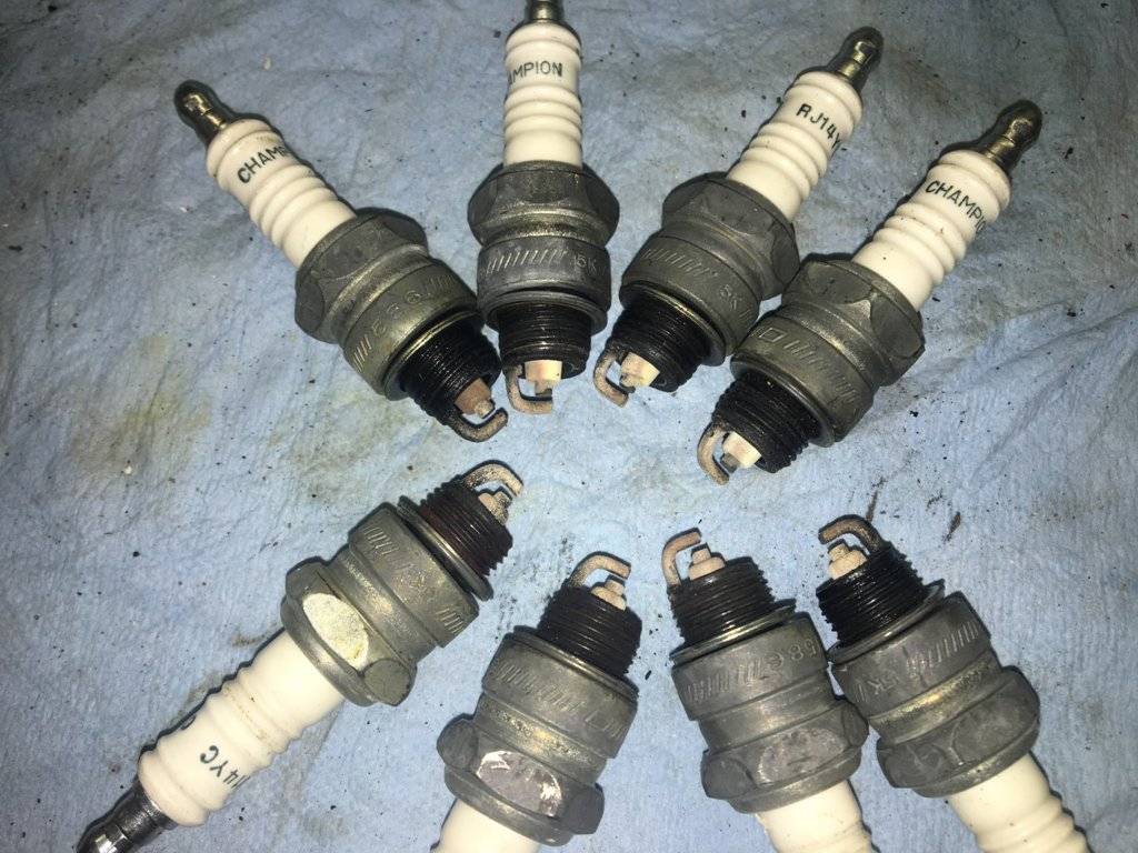

It was time to check the condition of the plugs after 20,000 miles of driving and I think the Poly engine was pretty well tuned...
The top plugs are from the left bank
My buddy installed new plugs and tuned the carb to balance the banks evenly
Knock the minor deposit accumulation from the tips, dress the electrodes with a point file, regap, a drop of oil on the threads, and REINSTALL. Lookin' good.
