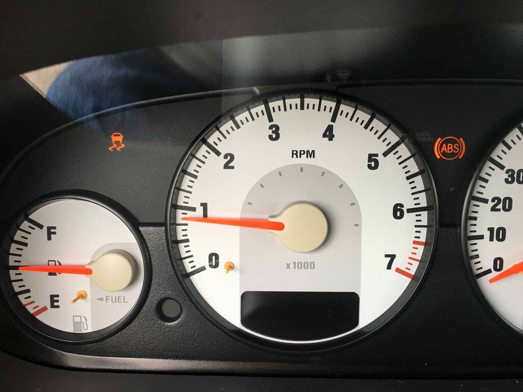

Hi All. I know there are some seasoned and working techs here (@65sporty etc), so I'm asking if anyone ever ran into this. 2005 Dodge Stratus SXT 2.7 V6, brakes feel completely normal. Runs normal. Yet, ABS & Traction Control Lights On. What was the problem? What did it cost to fix? Thanks, Ben
WHEEL SPEED SENSOR, IF YOU CAN GET IT SCANDED FOR FREE IT WILL BE EVEN CHEAPER TO FIX, FIND OUT WHICH WHEEL SENSOR HAS GONE BAD. DOES THE STEERING FEEL WEIRD AND HARDER ALSO? IF YOU CONTINUE TO DRIVE IN THIS CONDITION YOU MIGHT GET A CHECK ENG. LIGHT ALSO. CRUISE CONTROL WILL STOP WORKING ALSO UNTILL YOU FIX THE OTHER PROBLEM. SAME THING HAPPENED TO MY 2015 DART, SCAND IT, $23.00 WHEEL SPEED SENSOR PUT IT ON AND DROVE THE CAR A COUPLE TIMES AND ALL THE WARNING LIGHTS CLEARED THEMSELVES, EVEN THE CHECK ENG. LIGHT. NEVER SEEN THAT BEFORE. ANYWAY GOOD LUCK. MAKE SURE CRUISE COMES BACK AND POWER SREERING.
Speed sensors are the common items that tie both systems together. Traction control as to "side-to-side" wheel speed differences (driving wheels). ABS for comparison of all wheel speeds compared to each other. One wheel locks up, brake pressure to that wheel is decreased until the differential ends . . . humongous number of times/second.

The other thing that will trip both the ABS and Traction control lights is if you have one of those mini spares installed on the vehicle after a flat or other tire failure. As Willis explained, the sensors read the tire rotations, if one tire is a different size, those readings go south.

Charles Smith at Smith Auto, phone call. He is a friend of the family who is been in the automotive business for 50 years. The ABS light and the traction control light are not Virginia inspection items. Usually when the ABS goes, it will light the traction control as well. The problem is most likely with the ABS system. The problem could be a wheel sensor, wiring to the wheel sensors, or the antilock brake system computer itself. There’s simply no way to know the cost except by scanning and diagnostics. I called the owner back and canceled the appointment to see the car. This was a car I was considering purchasing. I advised him of the situation and what might be the causes and suggested that he get it looked at before he sells the vehicle. Thanks for all your help!

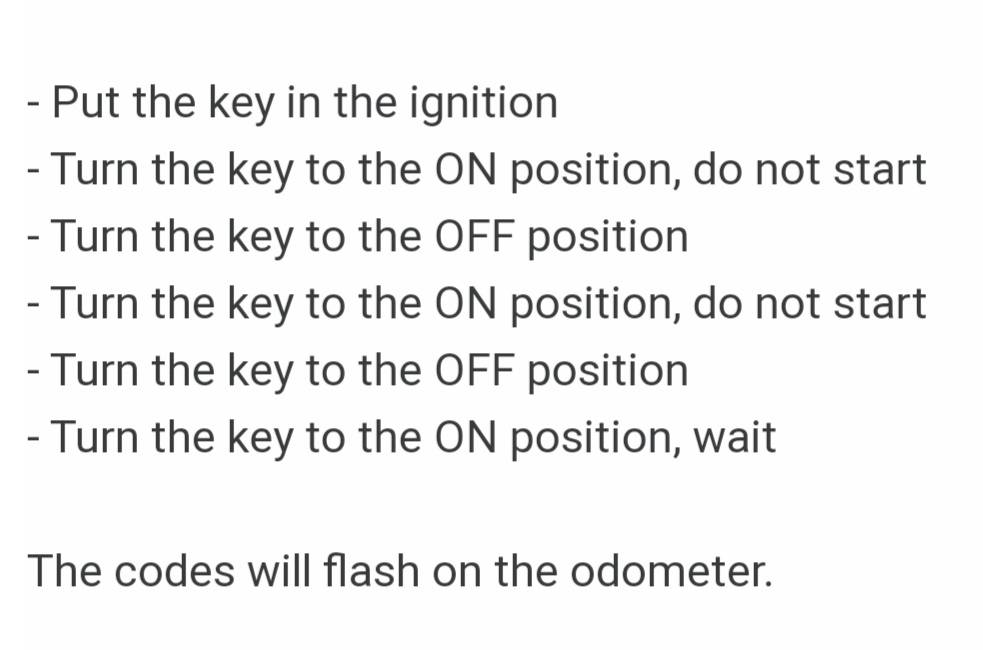

Does the "key dance" not work on the Stratus? It does on my '06 Magnum. It show's the code for the exact speed sensor, if that's what it is. My ABS light is on right now, with a recently replaced speed sensor. I read after buying a generic part that they're junk, and only dealership replacements will work. Which seems odd, I'll eventually find out.
