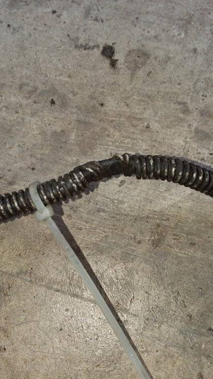

It wasn't the master. I started bleeding the brakes and got a sizable bubble from the right rear. Then discovered that I must have a collapsed line on the drivers side because I cannot get any fluid out of it. I just so love working on the dd.
I wish i knew where the air came from. It's gone and the drivers side is now fixed. They run them lines like a snake travels. In teaching them my 12 year old son noticed this in the line.
The line completely smashed shut for the driver side. The passenger side was right below with no damage.
