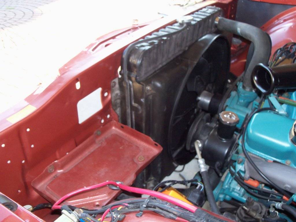

I upgraded from the 22 to 26 inch..

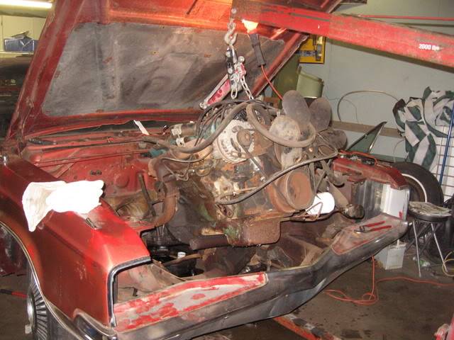

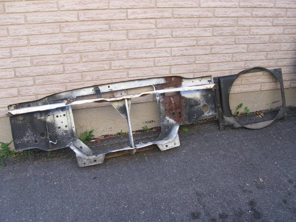

I liked the fact that you can pull the rad core out of the way for engine removal/install and leave the hood on.
See...now I was looking at that yesterday because I'm pulling my engine alone...that settles it...im pulling it out through the front and going to check the junkyard for another support. Anyone know which years and models will fit? I have a few newports, furys, possibly new yorker from 66 through 71 to choose from at the yard.
Wow! Great Work, cbarge!
Cool that you can pull the radiator support with bumper in place
My front bumper is a little more of an obstacle. Valence and bumper will have to come off when I remove my radiator support & engine.
