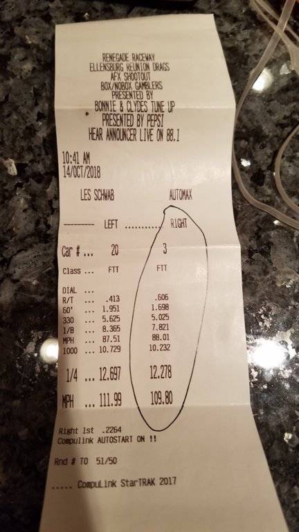

Got the new Mickey Thompson ET street R tires 275/50 15's mounted. They fit under the fender skirts. Should get me to 11.99. If you look close in the pic you can see the old M&H drag radial 275/60's under it.

How are shorter tires going to pick you up .279 of ET?
3.23 ratio, the 275/50's are ~2" shorter. Its not just the tires, i installed an O2 sensor bung so i can jet the overly rich quickfuel carb, and lean it our a bit. I am hoping the shorter tire and properly jetted carb will pull off a 11.99
I agree with your 3.23 will need those shorter tires. Your new ones are about 2.2” shorter. Tuning always helps.
