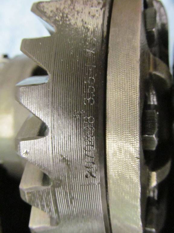

    While looking though my stash of 8 3/4 center sections. I only had 1 Sure Grip unit. There was no tag so I counted the ring gear & pinion gear teeth. I came up with a 3.08 gear. It’s a 489 case. Did they offer a 3.08 Sure Grip ? Never heard that ratio before.

    2.94 -3.23
    Count again.

    Ok that’s what I though. A math error. So did they offer a 2.94 Sure Grip ?

    Yes, I have 2 of them being rebuilt now.
    It’s stamped right on the edge of the ring gear exactly what it is.

    For reference, on GM OEM gears, the tooth count of the package is on the edge of the ring gear, in a "heavy stamp" (i.e., 39T-10T), so you still have to do the match.
    Thanks for that picture!

    Yea I looked & had a friend double check. We didn’t see anything. I have a 3.55 also & it’s stamped. May have been a service part. IDK.

    Hum, well I’ll be darn. I’m pretty sure I counted the teeth correctly. I always mark 1 & count 3 times. I wrote to numbers for both the ring & pinion gears down just can’t find it. That’s interesting info Jer. Thanks for that. I just never heard of a 3.08 myself

    Depending on the year and casting there are different numbers stamped into the gear, some are date codes, part numbers. Would love to see a photo of an actual gear stamped 3.08... That didn't come from a first gen Cummins truck with the 727 (not an 8 3/4)
