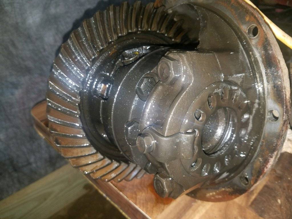

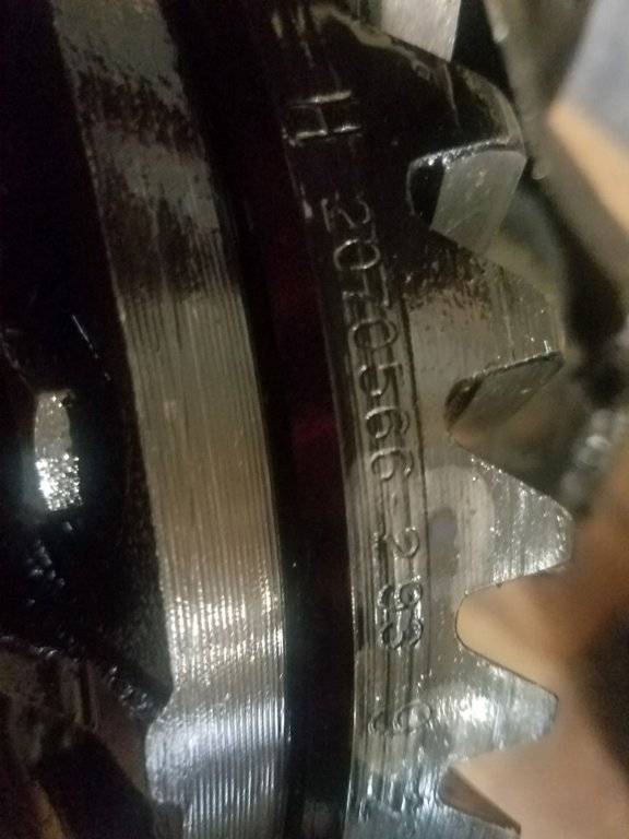

I have a complete unmolested 742 center section. It has the strongest sure grip made . A dana power lok. stock gear ratio of 2.93 to 1 500.00 plus shipping from 14048 .
