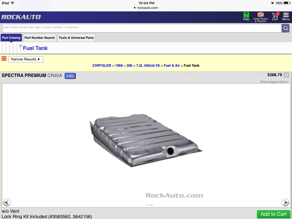

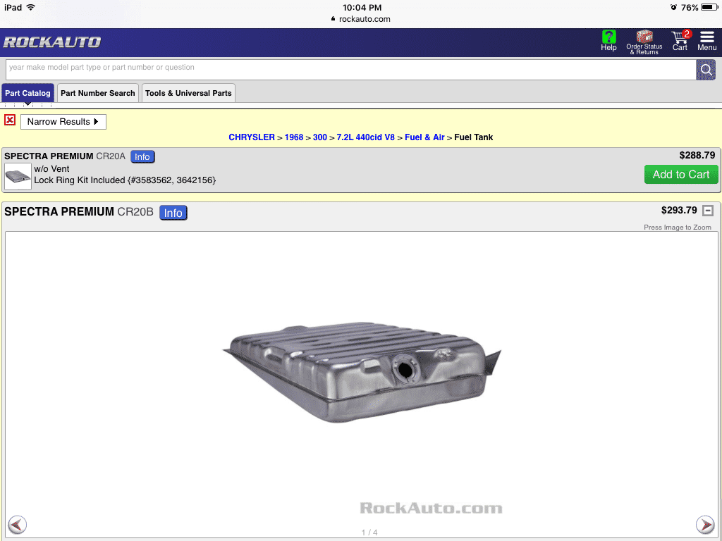

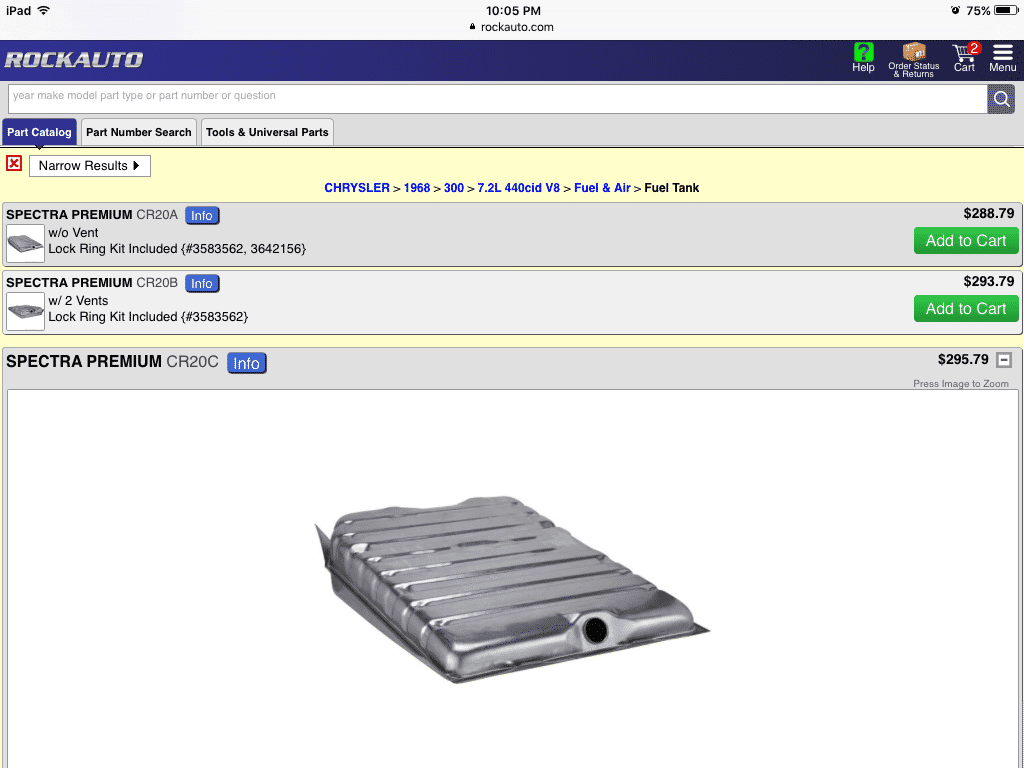

    I have a 1968 300 convertible that's missing it's tank and neck.
    Rock auto list these three, which ones would work.

    The only difference in the tanks is the number of vent tubes. There is one tank with no vent tubes, one with two vent tubes and one with 4 vent tubes. Cars equipped with Federal Emissions have 2 vent tubes, cars equipped with 4 vent tubes were equipped with California emissions. I think, but I am not sure that the tank with no vent tubes was the model for Canada.

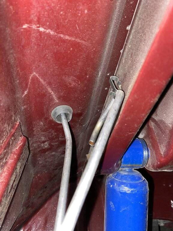

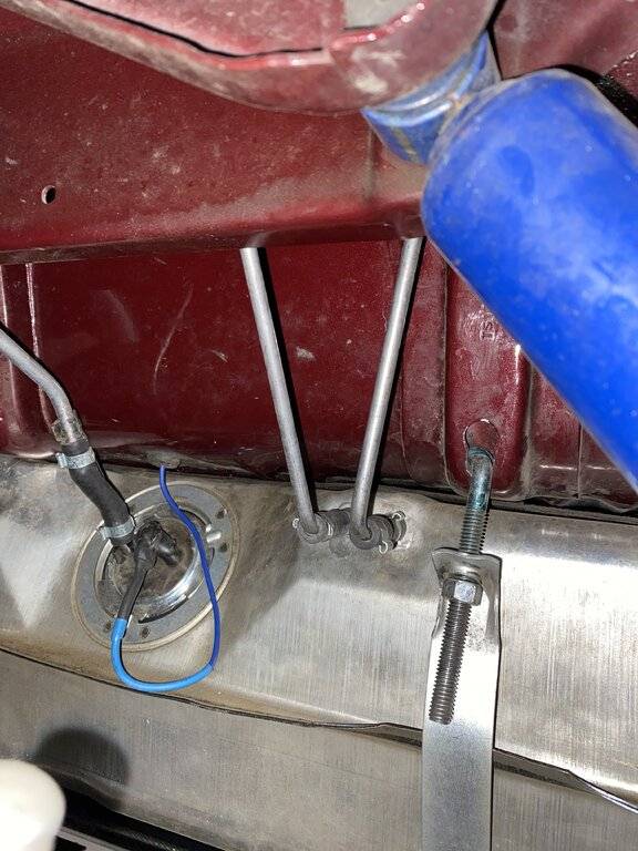

    For ‘68 all C-bodies were two vent. One vent tube goes up and vents by upper shock mount the other goes up into the trunk and then goes across and vents into the unibody frame. With shipping Vans was the best deal for me.
