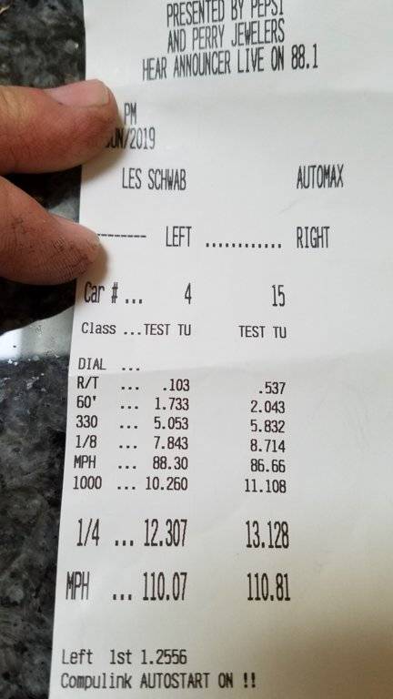

These guys built my 2800 stall. With modern cam grinds, the old "big cams have no bottom end" is greatly minimized. My car is an absolute hand grenade down low and pulls like a jet up top.
Home - A-1 Performance Trans & Converters
Works great and is unnoticeable on the street.
12.80's! That's awesome!
Faster than that now. 12.30's@ 110
