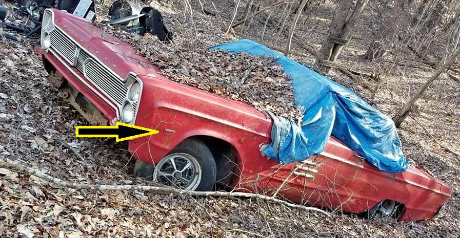

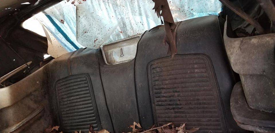

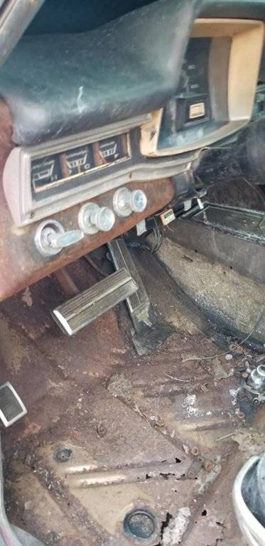

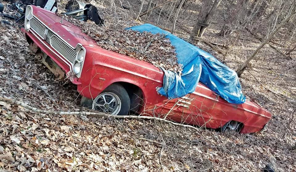

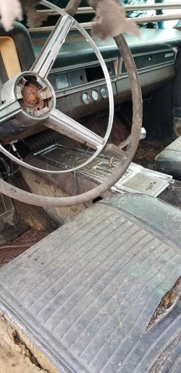

haha you guys are crackin me up tonite… So I found a semi local parts car. 66 Sport Fury Convertible in pretty rough shape and the owner is saying it's a 318 according to the vin. here's a couple more pics. Flat tires, no carb, floors rusted thru, seats in bad shape, gauges mounted in the dash, etc. Then they took down some of the less flattering pics, so long story short I've made an offer and I'm waiting them out! There's a few parts I could deff use from this car and if you look closely, there's damage/rust/rot from one end to the other!

Looks like quite a few good parts in that parts car. Steering wheel not all cracked up, maybe a nice dash pad, console might be good, bunch of trim, etc. I would think the undercarriage is in not so great of shape, with the car sitting on the ground.
Is that a Commando V8 emblem on the front fender? Either someone added the emblem when the 383 went in (318 cars didn't get them) or the owner is not interpreting the VIN correctly. Hope you get the car, Mr. Harrison.
