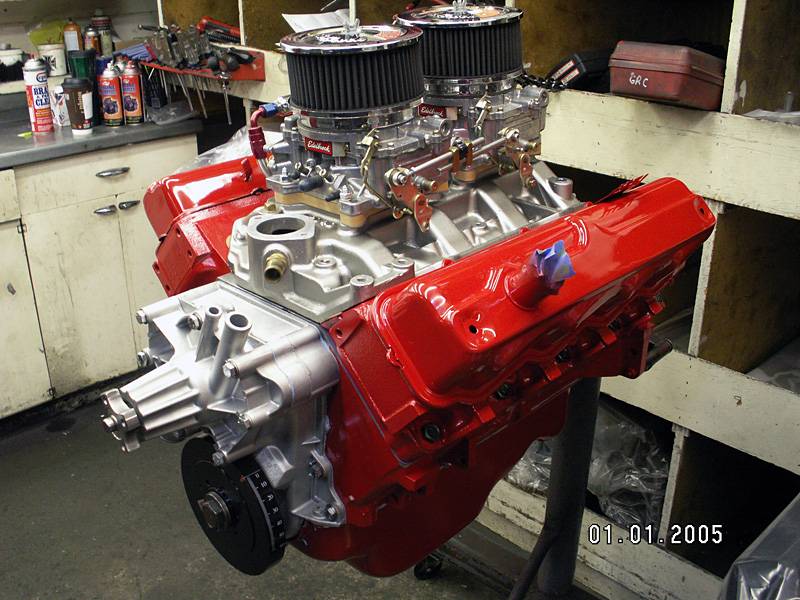

    I would be inclined to go in this direction. . .

    Not sure I want to know what that intake and build cost! Sure is sexy though!

    No big deal. Thirty over bore, two four-barrel carbs, a hotter cam and maybe higher compression pistons - but maybe not.

    Which carbs are you running on this?

    I don't know. Generic Edelbrock?
