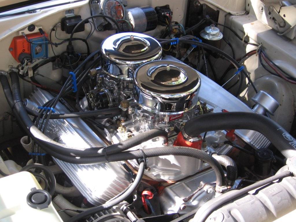

Hello everyone,
I've got a 66 Sport Fury with a nice 318 poly under her skirt. I've been talked off the engine swap cliff and have learned to love my lil semi-hemi. I'm always dreaming of what I should do next to the car and would like some input. I've already done, edelbrock 4bbl swap, front disk breaks, some creature comforts, and a gibson exhaust. The cars mostly a cruiser but I'd like to give her some more go. I dream of going big one day and fully building the engine but for now I'm just a broke college kid. I'd like opinions on what I should do next, I'm thinkinging either a chrysler power intake (currently using a late 60s single plane), tti headers (still using stock log headers), or a semi spicy cam (no clue if anyones cracked open the engine yet). Depending on what I chose to do I might also do some light porting to the heads, mostly gasket matching as touching the bowls sounds terrifying.

Back in the sixties I ran a 318 Poly. I had the factory dual quad manifold which worked nicely. One of the biggest improvements was when I added an Isky cam, solid lifters and springs. Along with that I also put a set of Hedman headers on it which were available back then. Both those modifications really made the poly come alive. They have pretty mild factory cams and the log manifolds are not the best. Your plan sounds good.

For now, focus on "a torque motor that will RPM", which is kind of where you're now at. There are some additional "hot rod things" which can consume money, decrease daily driveability and mpg, and not help nearly as much as you might expect. Being that is an approx 300 cid engine, it is VERY easy to over-cam it with a cam which might work well in a 360 or even 340. AND over-carb it too. You might investigate a better electronic ignition system and add some Iridium plugs to that mix. So . . . tweak, tune, optimize the carb and ignition tuning. "Cheap entertainment", too!
I can tell you one thing I've found out over the years, it's MUCH nicer to go out, hit the key, and things start happening nicely. Than having a rumpety-rump exhaust note that does not really smooth out as the engine warms up. Might get attention at a local cruise-in, but not the best for every day in, day out, use, to me.
Headers would be advisable, if available, with about a 2.25" low restriction dual exhaust system as a complimentary pairing.
Cam, for that size of motor, probably about 210-215 degrees duration @.050", with about .450" lift, and 112-114 degree lobe separation. If Lunati has something like that, PLUS the assymetrical lobe shape, that would be good, I believe.

Hey Reece, I have an overbored and hot rodded 318 in my 1960 Dodge Polara and have been around A block 318 all my life. What cfm AVS are you running? Believe it or not, you're hurting power on a stock or mild A318 using a Weiand 7503 single-plane intake, which is what I assume you are running since you said a "late 60's single-plane." Since you already have an new AVS carburetor, you will pick up performance by installing a factory 2-barrel intake and 2-to-4 barrel adapter since you can pick up 2-barrel intakes for little to nothing. Alternatively, you can install a factory iron 4-barrel intake, but they usually go for upwards of $400 which won't do for a "broke college kid." The factory 2 and 4 barrel intakes flow better than the Weiands unless the engine is built to turn high rpm.
As for the cam, a 264/.450"/110 cam wakes up a stock or mild A318 without needing to adjust the converter stall--if you're running an automatic--and rear gears. Keep in mind that LA cams and lifters don't interchange, so you'll need to get a cam from Racer Brown, Schneider, or Camcraft Cams and lifters from Melling or TRW.
Gasket matching the intake and heads will help some with a stock setup and help a lot if you put in the 264 cam. Coincidentally on another forum I was chatting with the person who built/runs www.poly318.com, and he's currently working on a technical article for porting A318 heads. He might be a good contact for you, and the website has a ton of information on our A blocks.

Thank you for bringing this site to my attention. I lucked out a found a factory 4barrel locally on the low which I think will drastically improve streetability. I think I'll hold off on my porting ambitious, aside from gasket matching, until poly318 does his post about it. After reading through his site I want to do a lot of the little work he's done inside all at once like the improved oil supply.
