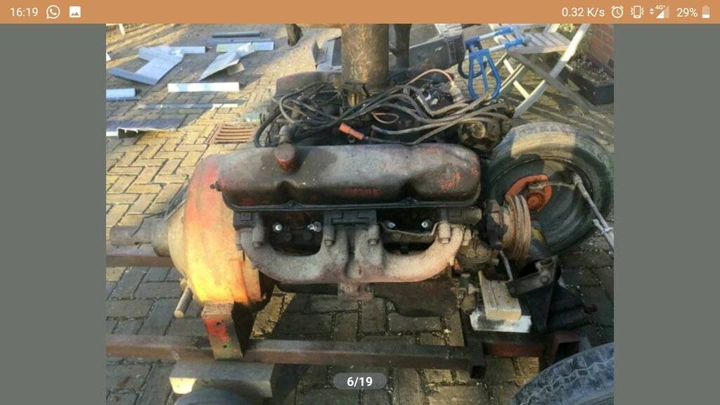

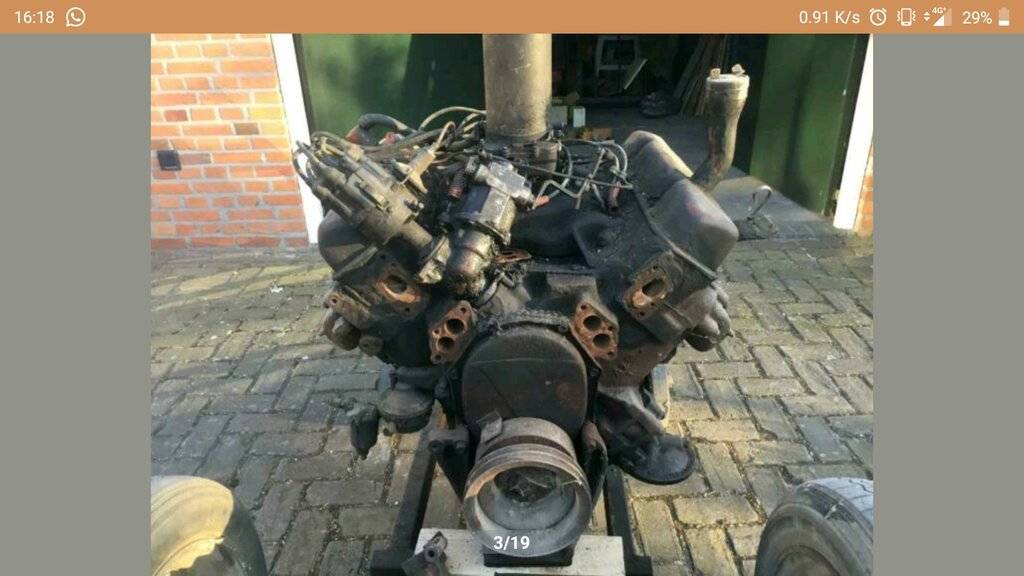

    Hi all,
    Couple of questions.
    My matching numbers 383 is disassembled and needs a lot of work for rebuilding. I'm thinking of dropping in another engine to be able to drive while I'm rebuilding my 383.
    383 are really hard to get over here (in the Netherlands).
    I came across a 361 industrial engine.
    Would this engine fit on my big block 727, motormounts, waterpump, distributor etc etc?
    In other words is that engine a drop in replacement?

    As is, no.
    The heads have the additional cooling ports in the front and are something you only see on industrial and occasionally on some RV engines.
    So... You might be able to use the short block, but most likely the oil pan is going to different. The oil pump has a different oil filter mount, harmonic balancer is thicker, which is going to cause issues with getting the pulleys to match up.
    Then, and I can't remember for sure on this, but there's a possibility that the flange on the rear of the crank is different, possibly like the 50's style Hemi crank.
    So, it's not going to just bolt in...

    It may and it may not...
    Things to keep on mind (and please remember that I'm NOT an expert on this, and I'm only speaking from what I've heard, and therefore may be perpetuating misinformation):
    Some industrial and marine engines rotate reverse to automotive engines.
    The heads may have different exhaust port configuration.
    Water pump housings are sometimes different.
    Transmission mounting, including the spline etc may be different.
    Bosses for standard automotive accessories like power steering, motor mount bosses etc may be different.

    There were 361 car, truck, and industrial variations. Each probably had customized items for each application. By "truck", I'm meaning "medium-duty" rather than normal "pickup truck".
    Even if the particular 361 had come out of a car application, it might still have a few year-model-specific items that could complicate the desired installation in place of the 383.
    I know that in the case of early-70s 440s in medium-duty trucks, there were lots of differences between them and a normal 440 car motor. Especially on some bolt-on items, as water pumps, for example. Same with Chevy "car" 427s and Chevy C60 "truck" 427s.

    The engine in the photo also has a governor installed on the distributor, usually on industrial engines the governor would run the engine at a fixed RPM and adjust the throttle for increased load. As noted, it is going to be more trouble than it is worth to try and adapt this engine for automotive use. Nearly all the industrial engines have the large flange crank. The industrial heads have a center line water passage thru the intake that takes the place of the heat riser passage. This in addition to the extra coolant ports on the front of the heads was done to improve cooling. None of that stuff will bolt up and fit in an automotive application unless you use the 383 heads and intake. You will also need to use the 383 oil pump, pan and oil pick up and valve covers. Check the casting numbers on the block, the engine in the photo appears to have an RB ID pad next to the distributor, might be a 413.

    I would be TEMPTED to cop that motor, strip it down to a short block, bolt on the 383 accessories and run it, IFF the crank could be mated to the torque converter. I've been intrigued by the notion of using an industrial engine myself. The large flange crank might be the showstopper here. I'd research WELL before spending a cent.......

    The block is about all you can use on that 361. You can have your 383 built and installed in the time it would take to make that 361 viable with parts you don't have.
