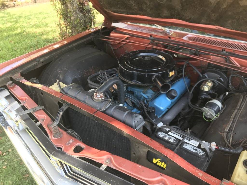

Here's how the air cleaner is positioned on my non AC 67 Newport. As Cbarge noted, 'FRONT' is stamped on the air cleaner, at least on mine, to show how it should be aligned.

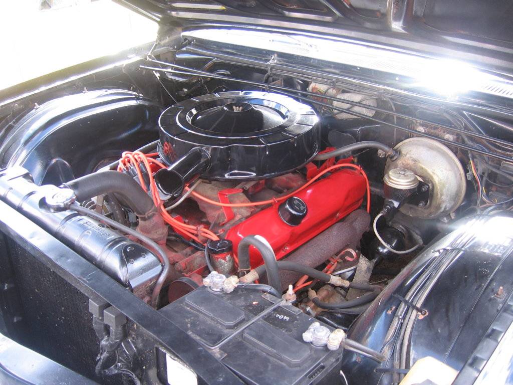

Can you show a pic of your 2-barrel air cleaner? This is a pic of my pops '66 TC. It originally came with a 2-barrel, but pops changed it over to a 4-barrel. Snorkel pointing forward as indicated by word "FRONT" and the dimple for the compressor as CBARGE pointed out.
