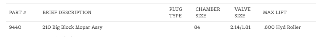

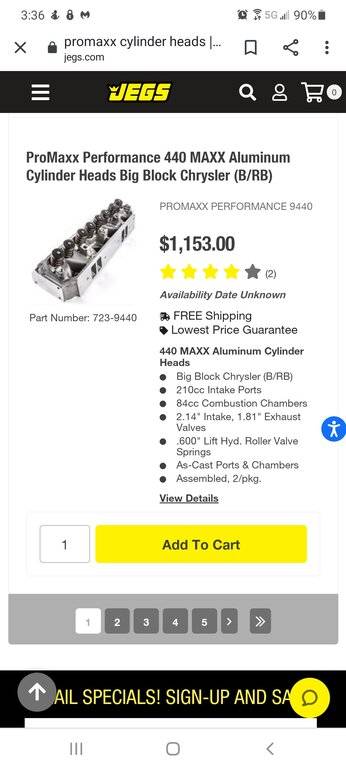

I have these heads on my engine.
I had seen that Jegs set and I'm guessing that's what you used. It also added to my confusion as to why the Edelbrock setup excludes 67 and earlier and the Pro Maxx does not. What changed in 68?
The factory went from a closed chamber head to the later open chamber design in '68. The bolt pattern is the same. Whoever did the add probably went with the info in the factory parts books. The open chamber head has a larger dome on the combustion chamber so if you bolt it on to the '67 or older engine, it will drop the compression ratio about a full point. The factory compensated for the larger chamber by running the pistons higher in the bore to keep the comp ratio at about 10-1 on the '68 performance models. If the higher comp ratio is important to you, you could consider having the closed chamber heads reworked and ported to take the 1.72 valves. This would give a good boost in performance at about the same price as the aluminum heads. The aluminum heads have a much higher flow potential potential above 4000 rpms, but to get that you are going to need an after market high performance cam, intake, carb and exhaust to get much increased horsepower out of the better heads.

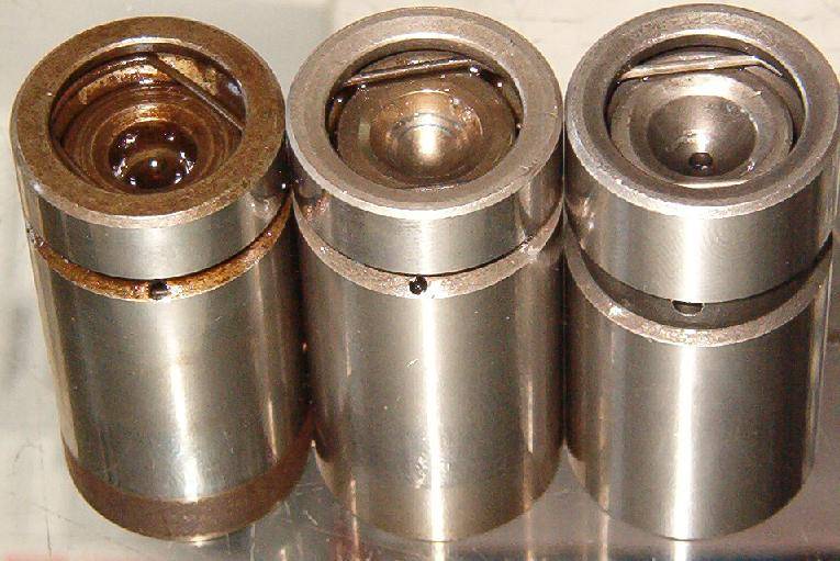

Big blocks up through 1967 used different hydraulic lifters and pushrods than the 1968+ engines. The early lifters had a smaller-diameter cup than the later lifters, and the cup was a bit further recessed in the lifter, so you needed matching pushrods which were slightly longer and had the smaller ball on one end.
That is why a lot of cam and lifter sets say they are for 1968+ B/RB only. If you're buying a kit that includes lifters and it says for 1968+ only, I am sure that is the reason why. If you are installing 1968+ lifters AND the corresponding pushrods, then it's not an issue.
