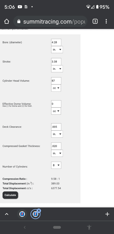

9.58:1 according to summit compression calculator.

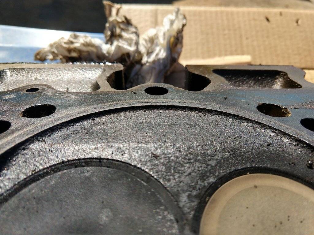

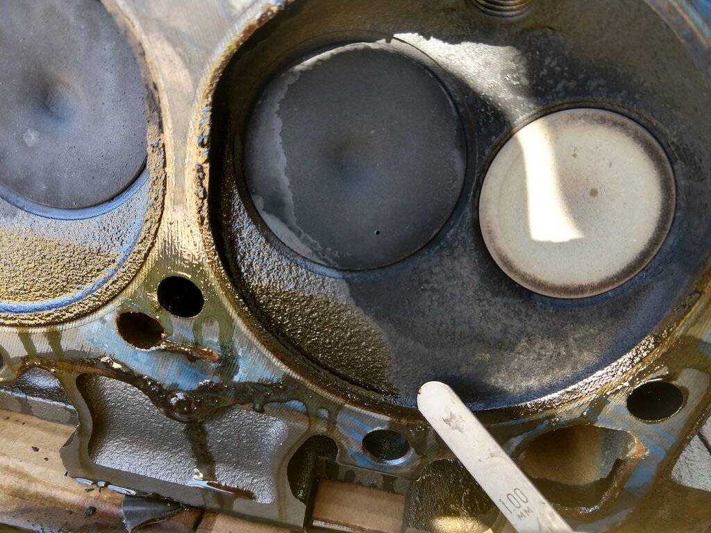

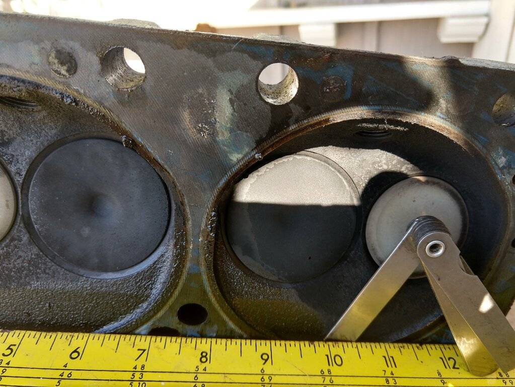

Thanks guys, the pistons are down .005 -.012 from a dial indicator years ago one side better then the other. The cam is mild, has a longer duration Melling 23204 specs are above, the carb right now is a holley 510-80508 750cfm and the dead area on the heads is big see pics, if you consider the dead area the flat area across from the spark plug. If I add the dead area to the approx .025 + I want to be under 60 right ? any concerns with valve clearance going to the steel gasket.

Valve clearance should not be any issue with that cam. Yes that big open expanse of detonation prone surface is not great. That plus gasket thickness, plus piston down in the hole gives you quench. The .020 gasket is almost .020 better than a .039 fel-pro,so your .019 closer to the magic .060, which no matter what is waaay better than a stock piston down in the hole .080 plus that dead area. So live with what you have, use the steel shim gaskets and enjoy a good running 383 with a appetite for 93 octane.
