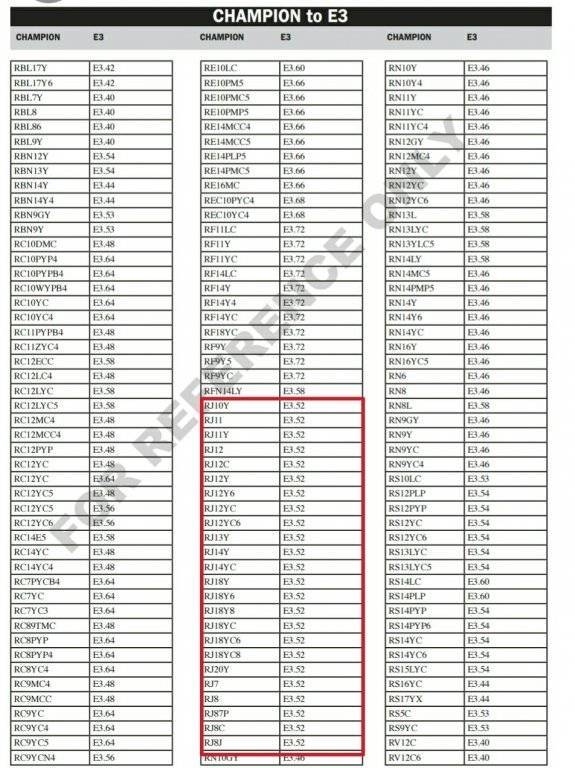

I guess i had that coming it was a dumb question, the reason i ask is i looked up some E3 spark plugs on there website and it said use E3.52 plugs. I looked them up on amazon and they said they dont fit your car ?
Amazon is wrong.
Why dont you just buy Champions in the first place.
I used to use Autolite exclusively and never had any issues. I have, in the not too distant past, tried Motorcraft and AC Delco with zero complaints. I have heard lots of bad stories about Champion plugs so I have never used them. I just stick with what has worked for me.
