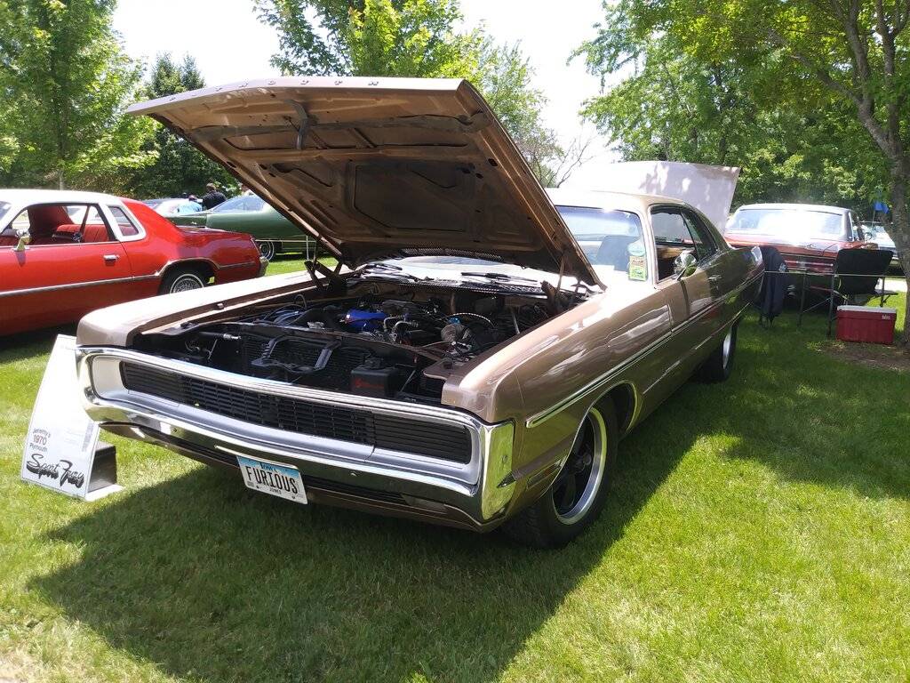

My 383 looks stock--but far from the truth.
Like yours,Mine started life as a 2bbl engine.
I am running a Comp Cam 268H (with the recommended matching valve springs) which is the max for a stock convertor.
I am also running a 750 Eddy (already had it and no cash to buy a 650) on the Eddy Performer 383 intake. I removed the "Edelbrock" and painted the intake to match the engine.
Despite having to bore my block and buy new pistons,we retained a 9.2/9.5ish Compression.
The TTi system works very well even with the log style or HP manifolds (which I have).
Restrictive?
Maybe but makes gobs of torque--which is what you need to move a big heavy car.
My old NYer I kept the logs and ran the TTi. It ate 5.0 Mustwangs all day!
For reliabilty,go with a Cloyes timing chain set and a Melling oil pump.
But as mentioned before in other threads,do your homework to see what works well TOGETHER!!
I had seen and fixed cars where owners bought "the best of the best parts " but none of the parts gelled and the engine was a dog.
Finally,the fine tuning,of ignition system and carburetor is where you get the most out of whatever "combo" you choose.
Hope this helps.

Thats the look I'm after. Ill probably run my hybrid chrysler distributor/ pickup with a hidden hei module. That is if I do away with the points.
And I'm considering trying to build a high flowing single exhaust. I have been plotting that for a different 4dr sedan I"m chasing.
Couple things
Having owned several mustangs I'd line up in a 5.0 against the run of the mill 383 boat :thumbsup:
Second, the oem style .020 shim gaskets held 12psi of boost in my 383 just fine, can't imagine why y'all would have any issues using them.
