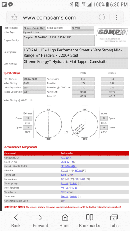

I will be running the double timing chain and yes i did the proper check on the bottom end. I think the xe274h cam will work better for my set up
I think I might just switch cams to a xe274h. Here are the specs for it. View attachment 180431
That is a better choice. Note that this cam will need a stall convertor and transmission valve body modifications and probably not produce enough vacuum to run a power brake booster. Ok with a vacuum booster pump and 2500 stall convertor. Fairly crappy mileage for a street machine. Might want to consider the 383 magnum cam as an alternative.

I would be very careful with regard to the piston to valve. E streets have larger intake valves, that camshaft has a fairly early and quick intake valve opening event, and the pistons have no reliefs. The closest the intake valve gets doesn't come at max lift, but rather during or just after the overlap event at the end of the exhaust stroke when the piston is moving away from TDC. You should put a layer of clay in line with the valves on the piston and carefully rotate the engine with checking springs in the heads to check piston to valve clearance.
With stock pistons, it would be good to aim for the max lift used on the HP/Magnum cams, as a general rule. I don't know that the cylinder head choice, per se, would affect piston/valve clearance, but the valve diameter in the heads being larger might.

I bet with that duration the XE275HL cam will clear. The .525" lift basically means nothing as far as V/P contact is concerned. A zero deck 383 with a .509" PurpleShaft hydraulic will have contact, almost guaranteed, I have seen customers do it TWICE on '69 model engines. Those MoPar cams have over 244* duration @.050" lift, which puts you in trouble quicker than the 231* intake duration of the XE275HL, or the 230* of the XE274H. Degree the cam to 106 intake centerline and verify the clearance just to be sure.
