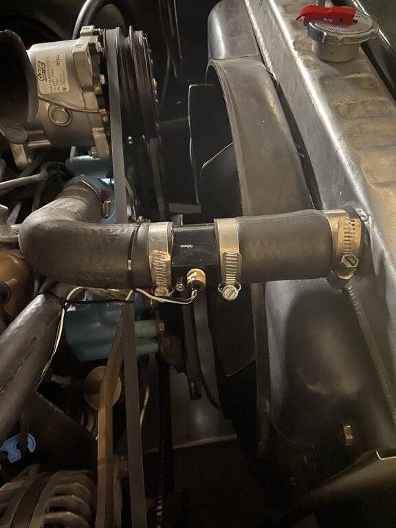

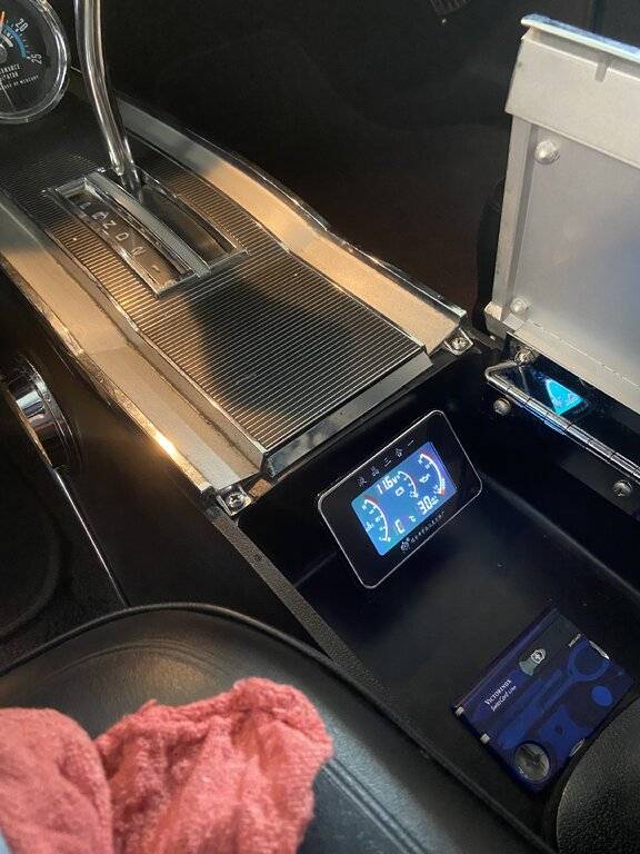

OK, you have me curious about that gauge setup. Details??

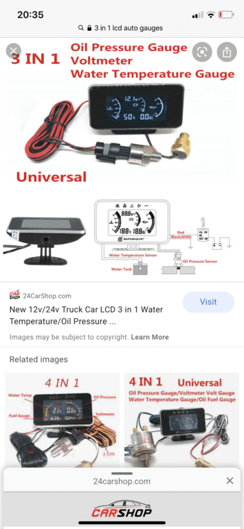

Well, I wanted something beyond the idiot lights and ammeter but there’s no good spot on my dash to hang a set of gauges. It just would have ruined the look of the dash. So I found this cheap but effective setup online. I like the hidden mounting. ( I guess this would would work well under the dash also as it’s mounted on a hinge so you could fold it back when you wanted to preserve the look) It works great but you’ve got to get used to Celsius for temp and pascals for oil pressure. It’s got a voltmeter also. It was all of twenty-five bucks plus another few bucks for the fitting to mount the water temp sender. (36mm) Going to put some tape over the foreign lettering. It was so cheap and effective that I bought two for a backup in case it fails.

Its a cheap bang for the buck, but I don't like electronic data sources, as I've seen too many fail with detrimental consequences, especially cheap stuff. I admit putting a gauge pod o the bottom of the dash does detract a little from the aesthetic, but not so much as a smoking, steaming, dead engine. I go with Made in the U.S.A. gauges only now. Try Clark Brothers if you're on a budget, as I am. You can sometimes find NOS Stewart Warner stuff surprisingly cheap too, but you DO have to look.
I probably would have used what you got 4 yrs ago, when I first got Tilly and wanted SOME GAUGES IMMEDIATELY. Good Luck and Happy Moparing.
