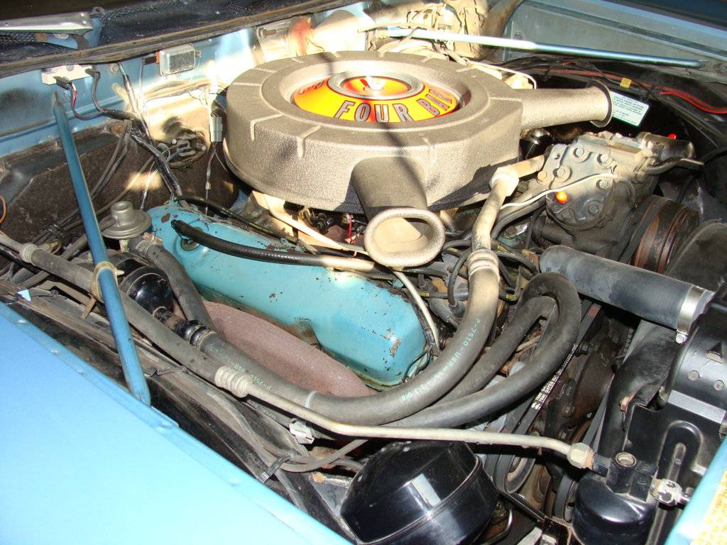

Decal shown in pic...
Hope this helps cheers.

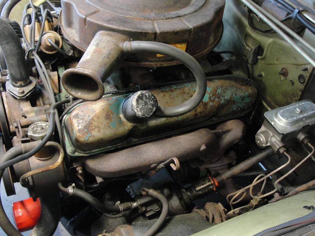

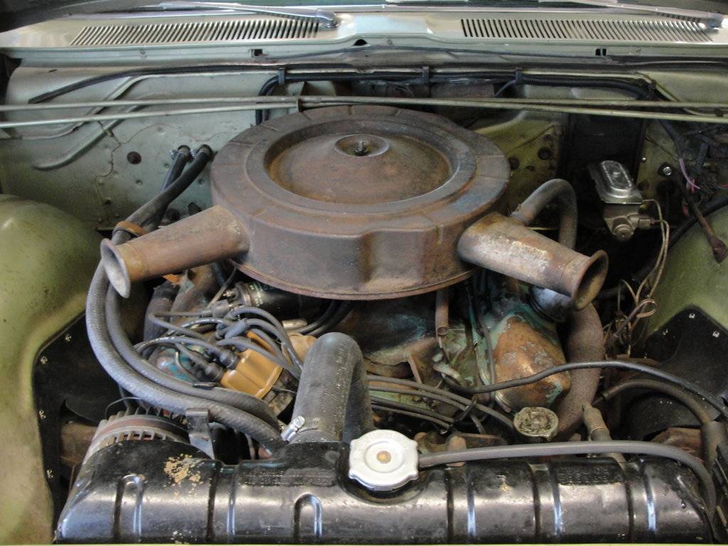

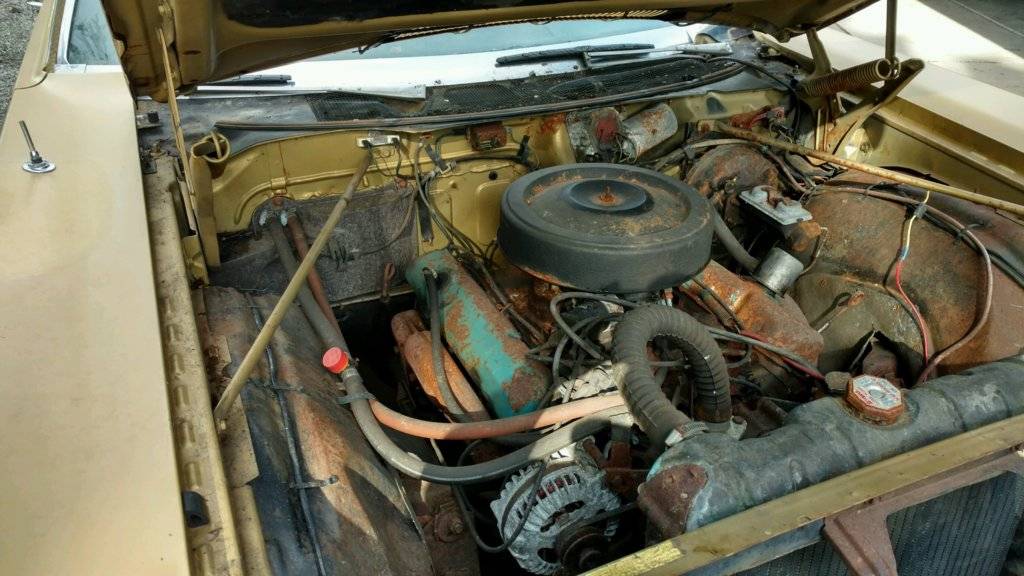

I know there were differences year to year. Here is a pic of a parts car that the owner took the engine and trans for a RR fake Belvedere.
I believe the car was unmolested and it had the same air cleaner as my 440HP. I suspect the pie tin was removed prior to the pic.

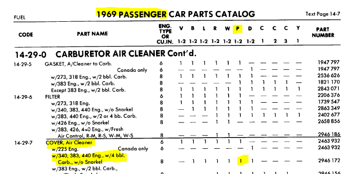

69 B body air cleaner w/o snorkel. (Among other vehicles and yes up here in Canada I had seen /6 cars with them now that I remember)
Thanks for sharing the added info that the C bodies also got the same air cleaner.

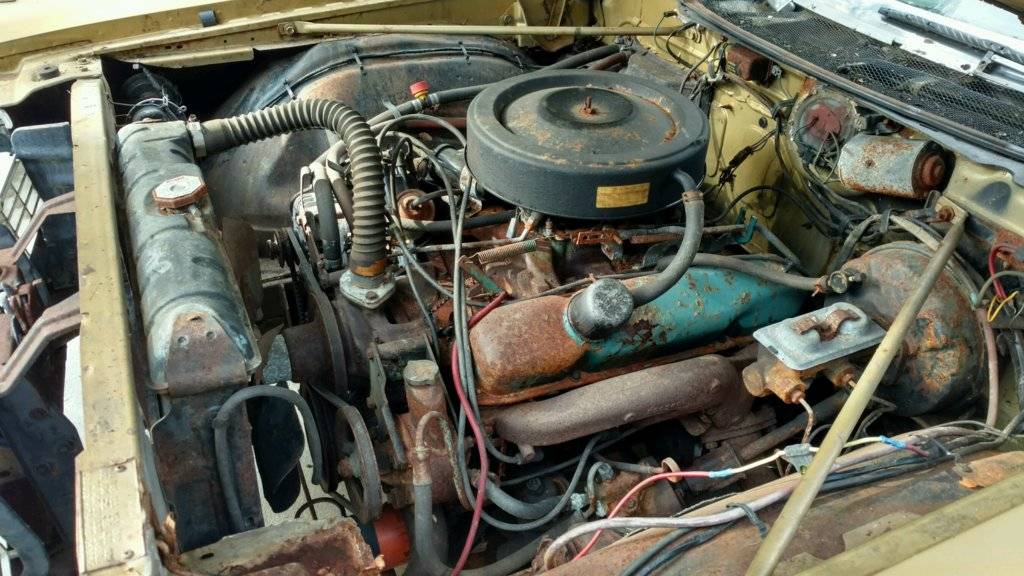

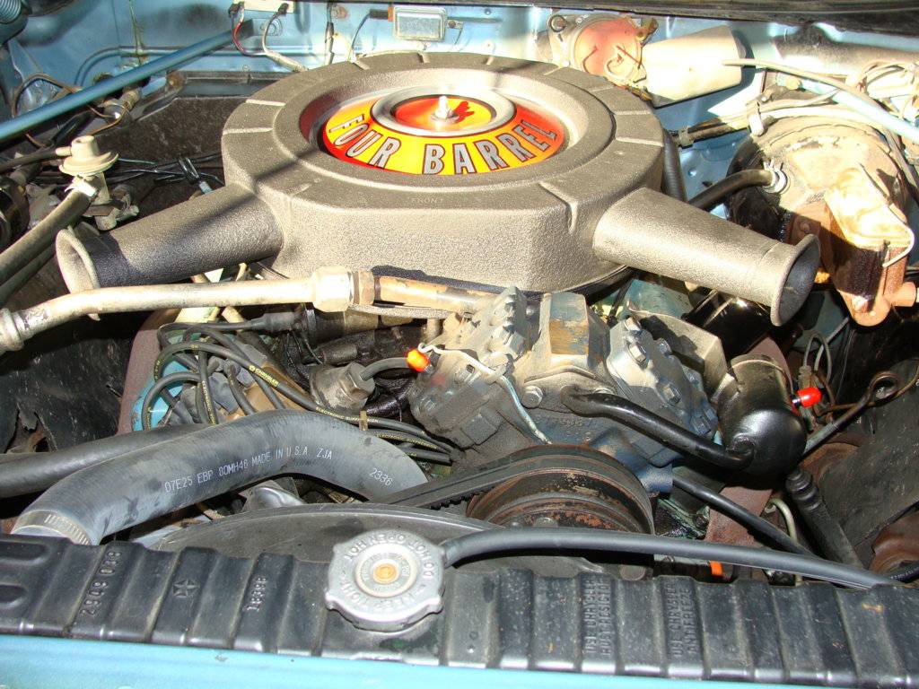

Mine has a sticker, (not there right now for a better pic), below the left snorkel
. There is residue of one on the left snorkel but I don't know what it was. FWiW, from what I understand, (for 68 Plymouth's only), the only 4 bbl 383 was the H-code. The difference between 330 & 335 versions was the air cleaner, silenced vs. un-silenced. If I'm wrong, please correct.
