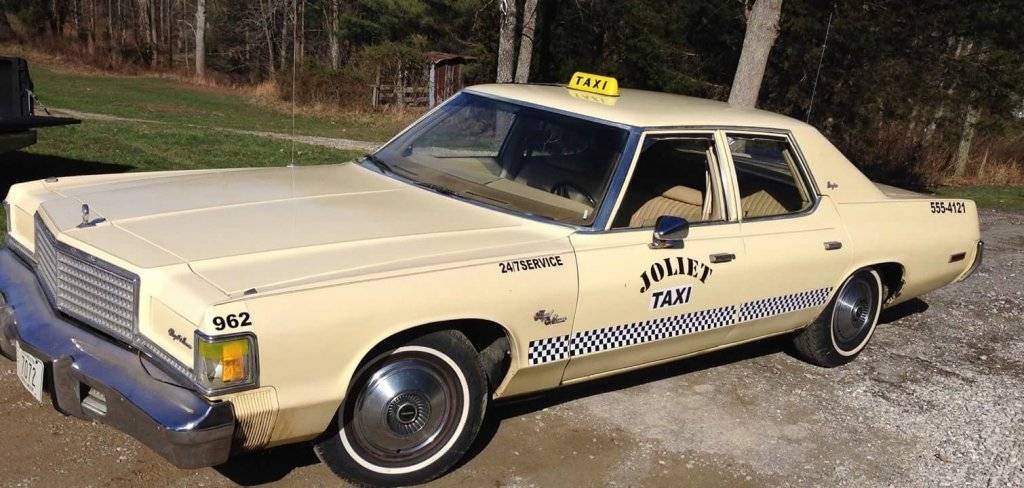

Just bought a '77 Monaco..Yes it's dressed as a taxi, yes it will receive a '74 clip, yes it will be black and white.
But, it's also receiving a modern 392 Hemi..I just swapped a 6.1 Hemi in a 70 Satellite. Now, I want to try my luck with this Monaco. With a couple mods it should have 400+ rwhp.
I'll post the build on here..I won't bore u with the Bluesmobile transition..But will document the hemi swap.

I'm actually liking that taxi cab look! It's different, and would make a hell of a sleeper!

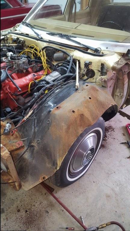

Began the nose swap..Took the '77 front clip off. Should look just like a '74 by the end of the week.
Biggest problem I foresee will be just getting the hemi and trans to sit right in the K frame. It was a pain with my '70 B-body and it had a lot of aftermarket support...This car has zero. Lol.

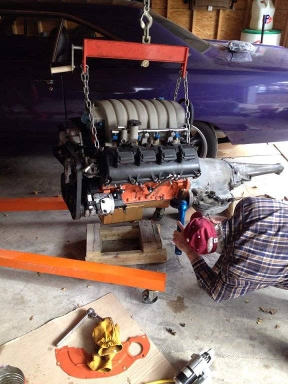

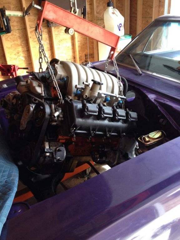

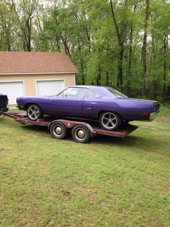

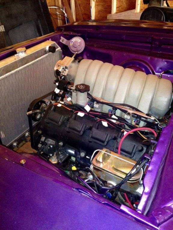

Some pics of the Satellite 6.1 swap. The Monaco will be fairly faster than this car..The 392 in stock form puts down 60-70 more rwhp than a 6.1.
Got my 9.25 rear this weekend also, gonna have it rebuilt with 3.90 gears and Yukon axels.
Very cool swap. What are you doing for brakes on the car? Don't see any booster, etc. Electric power brakes? Or . . .?
Doesn't show in those pics, but the Satellite got power disc brakes with drilled and slotted rotors. The Monaco is getting the same setup..Worked really well.
