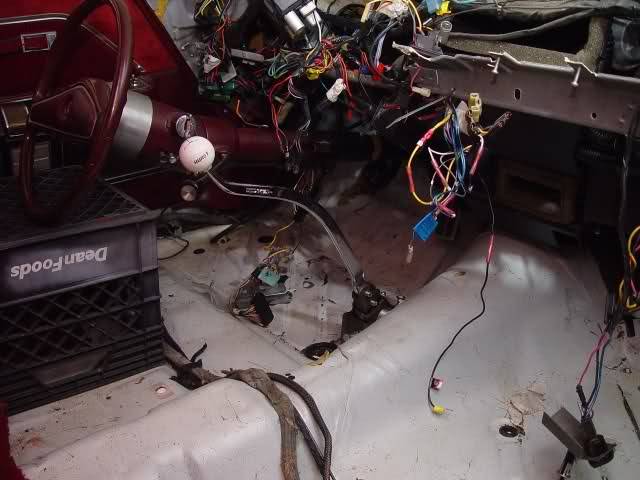

I see two or more wires that have multiple butt connectors.
Scary thought of leaving them like that especially after the dash gets installed.
What you dont see on the milk crate is "Please return to StitcherBob" LOL!!

That's another lesson Stitcher taught us. But he's Younger. It's not as tough on his back LOL

Wait until I install that wire octipus in Polaraco. The harness IS better than the 72 harness though

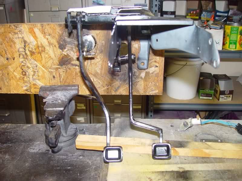

pictures would be nice. who was your slave cylinder supplier? pedal assembly?
No slave.
Late '80's Nissan Pathfinder master cylinder and a McLeod Racing hydraulic throw out bearing.
The pedal assembly was a highly modified stock brake pedal assembly with Jeep CJ clutch and brake pedals.
(private joke,long story,LOL)
Lea: bare hot wires may be just the solution I have been looking for. LMAO!!!
