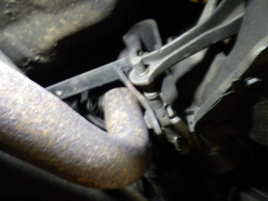

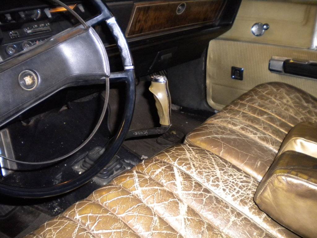

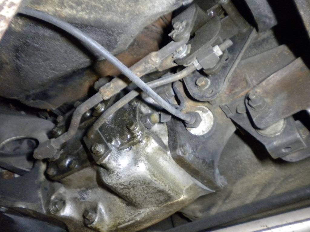

    newport and tv 006.JPG my '69 newport. shifter mech. and linkage from '83 c10 newport 002.JPG home made hump. easiest part of the conversion and yes it's necessary. newport and tv 007.JPG fabricated linkage. this and pedals, by far the most difficult part. all done late in the last century.
