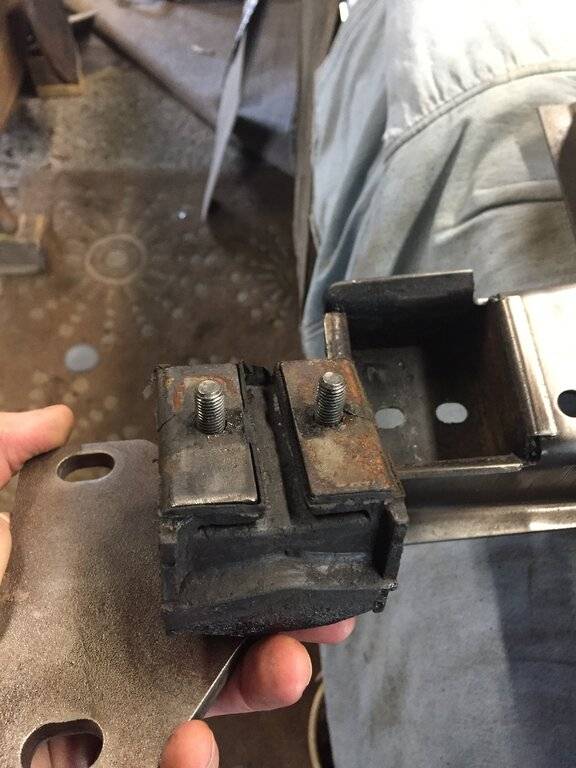

Hello fellas! It has been too far in between since my last post.My question is regarding the transmission mount. My 65 fury three had the small block 727 and 318, and now I am doing, what appears to be a fairly common swap, is the 440 and the big block 727. What are enthusiast’s doing regarding the transmission mount and the crossmember. Is there a mount which will fit the Big block 727 That will fit in my vehicles original crossmember? I have a few pictures also. Thank you for your support ladies and gentlemen.

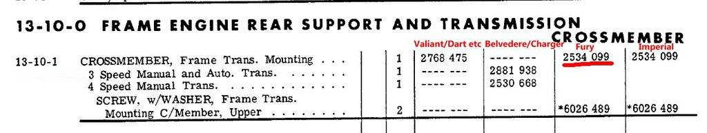

Check your parts manual it is your friend.

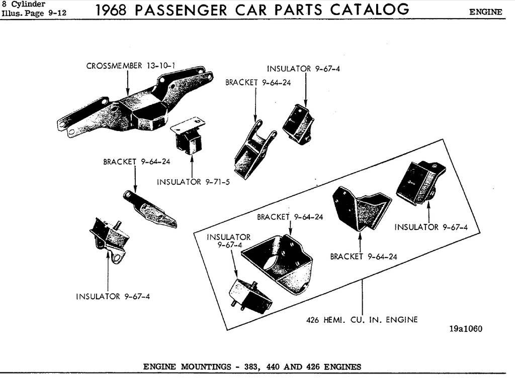

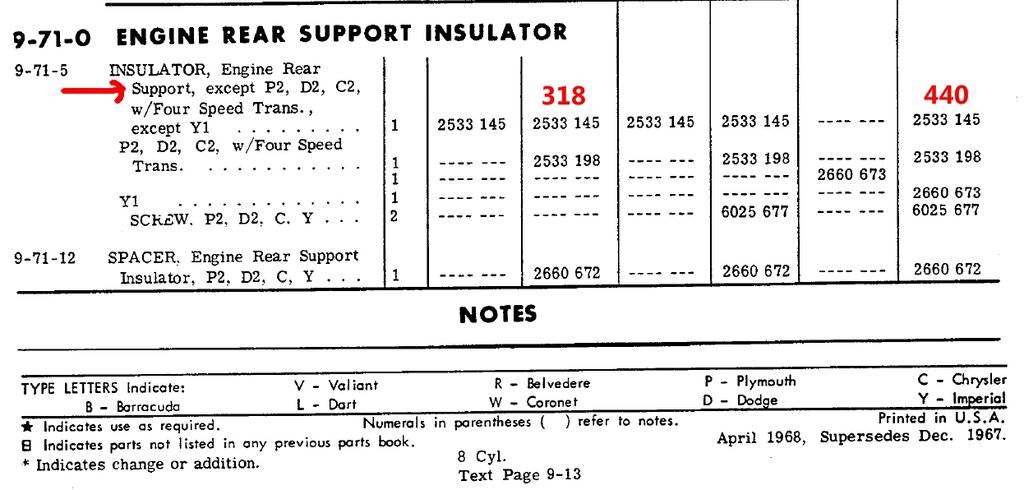

It appears that from small block to big block both transmission crossmember & insulator are the same part numbers with only the 4 speed insulator different.
The parts manual is a godsend. Funny they call them "insulators" that is a good description but not the term usually used; trans mount.

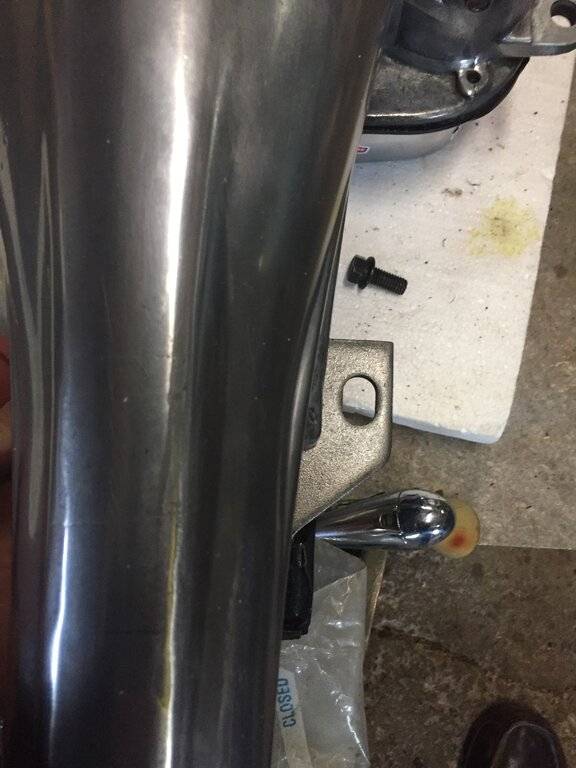

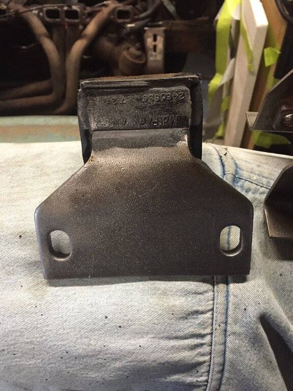

I took another picture today hoping this will explain more of my dilemma. As you can see, I have one bolt in the transmission mount, so you can see how off the holes are. I am aware that I can most probably drill some new holes and use this piece. I am not a purist, however I think there should be a part that I can bolt in directly to the transmission and crossmember. Anxiously awaiting a reply. Thank you ladies and gentlemen.
I think 65 back had 1 style themed 66 up had a little different style. I don’t think they interchange. Kim
Thank you Kim! They definitely do not fit both transmissions. I am adding some additional photos to further explain the dilemma. Thank you for your response.

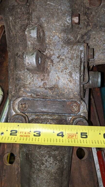

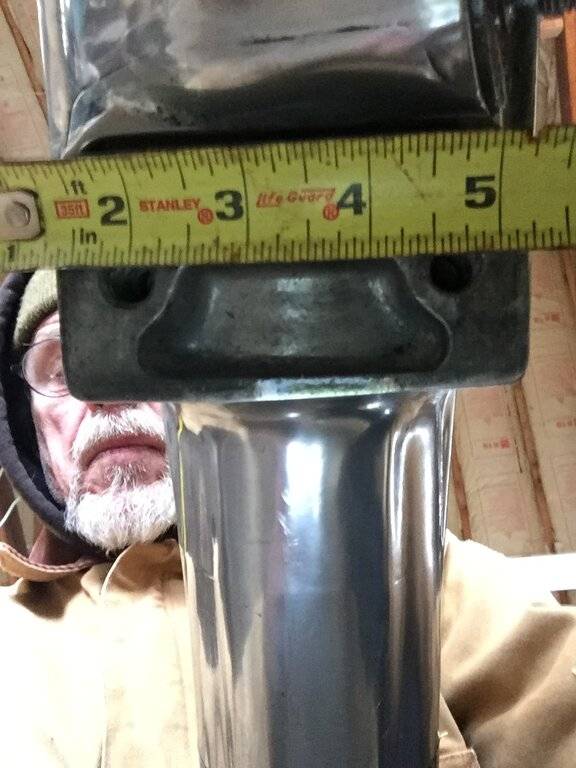

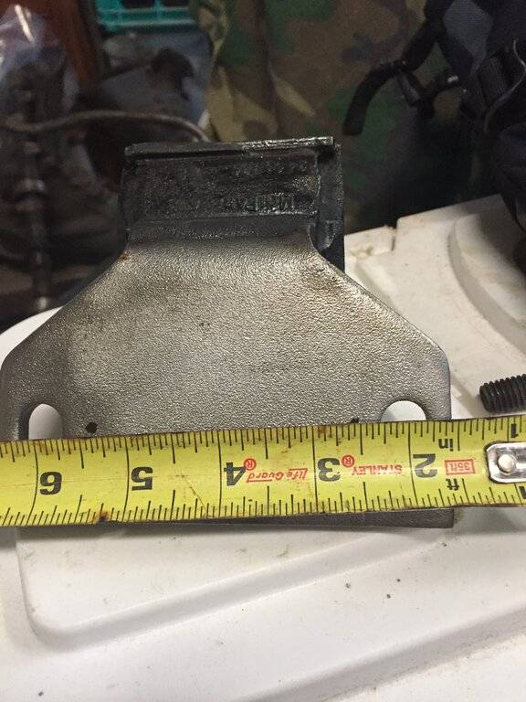

OK everybody that’s following this thread, I posted some additional photos and I have some measurements as well. The big block 727 transmission he has a 3 1/2 inch spread of the mount bolts center to center.The small block measurements are 4 inches Center to center. The bolts work in both small and big block application.
This
Bb approximately 2 1/2 ctc. I think there was a thread not to long ago with this same type dilema Kim
Thank you Kim, I stand corrected it does look like 2 1/2 inches center to center. I was hoping to find a direct bolt in replacement, but I may have to bring this to my shop and have the guys mill it for me.

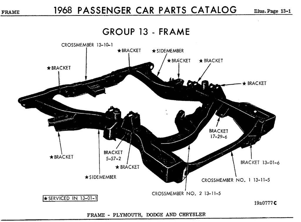

You probably got a 4 speed transmission insulator there in your picture as that appears to be the only difference in the 1968 parts book. I really doubt the 1965 frame is much different than the 1968, Chrysler didn't change much in the car line when body styles changed.
What you need to do is measure the 318 727 tailshaft mount holes, then measure the 440 727 tailshaft mount holes and I'll bet that they are the same.
Your in NY so it shouldn't be awfully hard to get the proper insulator rather than proceed into mickymouse land.

The insulator in the picture is from the small block 727. The bolt holes are 4 inches apart, the big block 727 that is going into the vehicle, he has bolt holes that are 2 1/2 inches apart.
