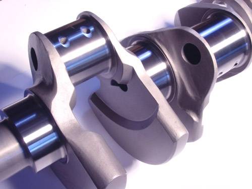

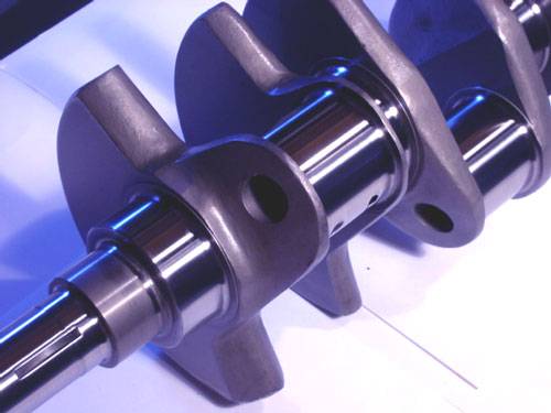

    Definitely a carb. My present 440 works great on a carb and points so my plan is the same fore the stroker. As far as the lightened crank there are apparently 4 different cranks for the same displacement stroker offered. Here is the descriptions of them.
    [​IMG]
    Home > Crankshafts > 4.250" Stroke Crankshafts
    Item # Image Description Price
    Crankshaft
    This crank is popular for doing 512" stroker setups in a low deck 400 block. This crank features the 2.2" (Chevy) smaller and lighter rod journals which allow you to use any off the shelf big block Chevy rods with perfect side clearance. The reduced diameter counterweights allow for easy block clearancing. This crank has the following specs: Stroke: 4.250" / Block Type: B / Main Journal Diameter: 2.625" / Rod Journal Diameter: 2.200" / Rod Journal Width: 2.009" / Pre-Balanced Bobweight: 2300 Grams / Counterweight Diameter: 7.120" / Flange Bolts: 6 x 7/16".
    In Stock
    $749.95
    Crankshaft
    This crank is popular for doing 512" stroker setups in an "RB" (413/426/440) block. This crank features the 2.2" (Chevy) smaller and lighter rod journals which allow you to use any off the shelf big block Chevy rods with perfect side clearance. Crank has the following specs: Stroke: 4.250" / Block Type: RB / Main Journal Diameter: 2.750" / Rod Journal Diameter: 2.200" / Rod Journal Width: 2.009" / Pre-Balanced Bobweight: 2400 Grams / Counterweight Diameter: 7.480" / Flange Bolts: 6 x 7/16".
    In Stock
    $749.95
    Ultralight Crankshaft
    Our new 4.250" stroke ultralight crankshafts are great for those 512 stroker motors. Since this combination already uses a lightweight piston, we undercut the crankshaft counterweights and profile the flange into a star shape, which takes about an additional 4 pounds (1800 grams) off this model crank. Click on the "View Additional Images" button on the product page to see more. Although the 512 is a quick revving combination even with a standard crankshaft, this ultralight crank will really make it rev like a streetbike. This crank features the 2.2" (Chevy) smaller and lighter rod journals which allow you to use any off the shelf big block Chevy rods with perfect side clearance. The reduced diameter counterweights allow for easy block clearancing. This crank has the following specs: Stroke: 4.250" / Block Type: B / Main Journal Diameter: 2.625" / Rod Journal Diameter: 2.200" / Rod Journal Width: 2.009" / Pre-Balanced Bobweight: 2300 Grams / Counterweight Diameter: 7.120" / Flange Bolts: 6 x 7/16".
    In Stock
    $899.95
    Our new 4.250" stroke ultralight crankshafts are great for those 512 stroker motors. Since this combination already uses a lightweight piston, we undercut the crankshaft counterweights and profile the flange into a star shape, which takes about an additional 6.5 pounds (almost 3000 grams) off this model of crank. Click on the "View Additional Images" button on the product page to see more. Although the 512 is a quick revving combination even with a standard crankshaft, this ultralight crank will really make it rev like a streetbike. This crank features the 2.2" (Chevy) smaller and lighter rod journals which allow you to use any off the shelf big block Chevy rods with perfect side clearance. Crank has the following specs: Stroke: 4.250" / Block Type: RB / Main Journal Diameter: 2.750" / Rod Journal Diameter: 2.200" / Rod Journal Width: 2.009" / Pre-Balanced Bobweight: 2400 Grams / Counterweight Diameter: 7.480" / Flange Bolts: 6 x 7/16".
    In Stock
    $899.95

    Only 2 of those are 440 cranks, the other 2 are 400. Note that these lightweight shafts have the smaller Chev style rod bearing journals (Big Block) with less bearing surface area. Stock mopar 2.375". chev 2.2". That was part of the reason the the Chevy folks spent so much time sweeping up engine parts, weak lower end.
    Dave

    I would suggest staying with a stroker kit that maintains the stock rod journal size 2.375", the hefty bearing surface area is one of the reasons that a mopar big block would stay in one piece.
