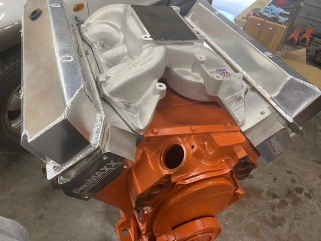

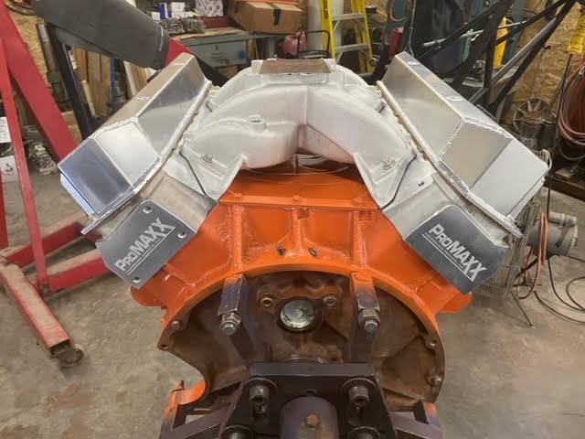

I am looking for an HEI ignition to add to the 440. I ordered the ready to run billet kit from Competition Products for $206 but found that it wont work with fabricated valve covers. I attached a couple of pictures of where he is with the build, and so you can see the valve covers. Any recommendations for an HEI setup that would work?
Think pro comp makes this one. I have one nors I can measure from the flange up, then there is hood clearance.
Nice looking valve covers, but NOW we know why the ends are rounded and curved as they are.

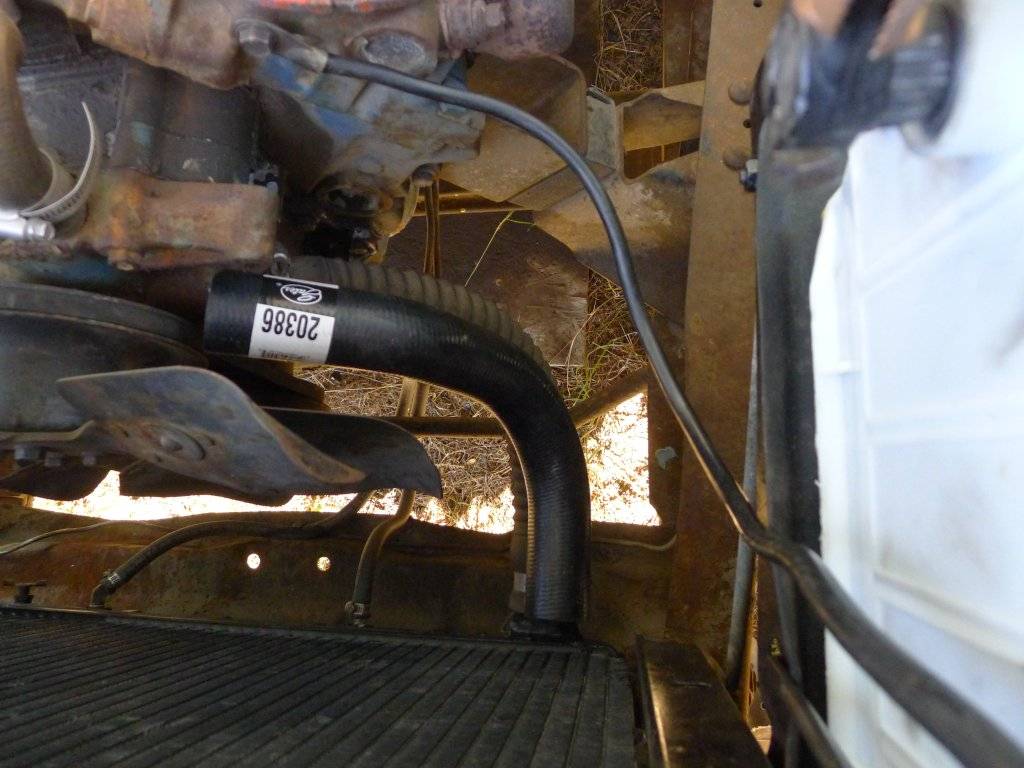

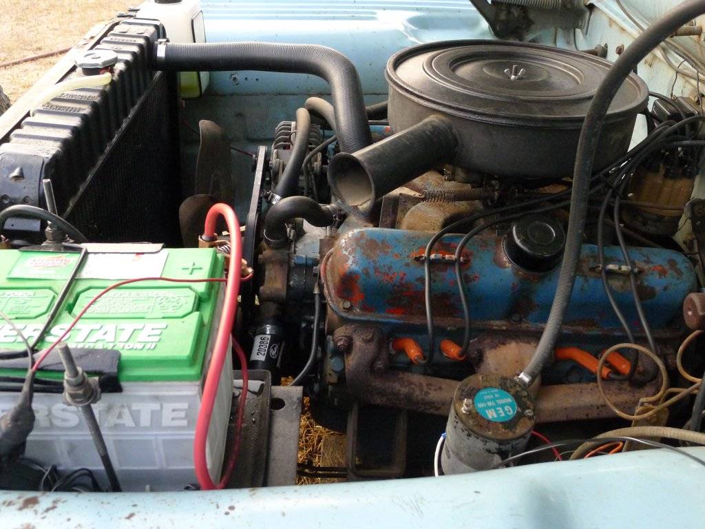

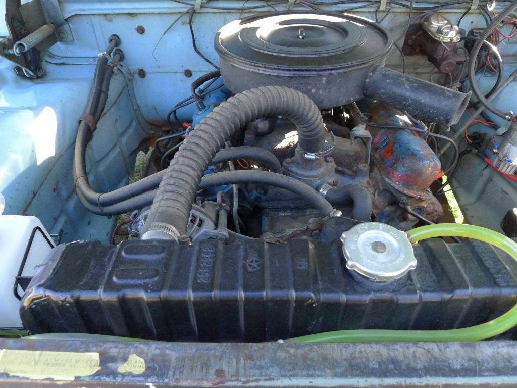

Way too nice and clean for that flex hose. Finally got rid of mine this year, awesome!
Took me a couple years to find the right top/bottom hoses ('66 Monaco 383/AC 3 row rad core in '69 D200 p'up) but they are out there.
View attachment 562477View attachment 562478View attachment 562479
lol after a couple attempts I was finally able to pick up the bottom (non flex style)hose but gave up after getting the wrong top one multiple times even taking in the old one for them to match it up to.

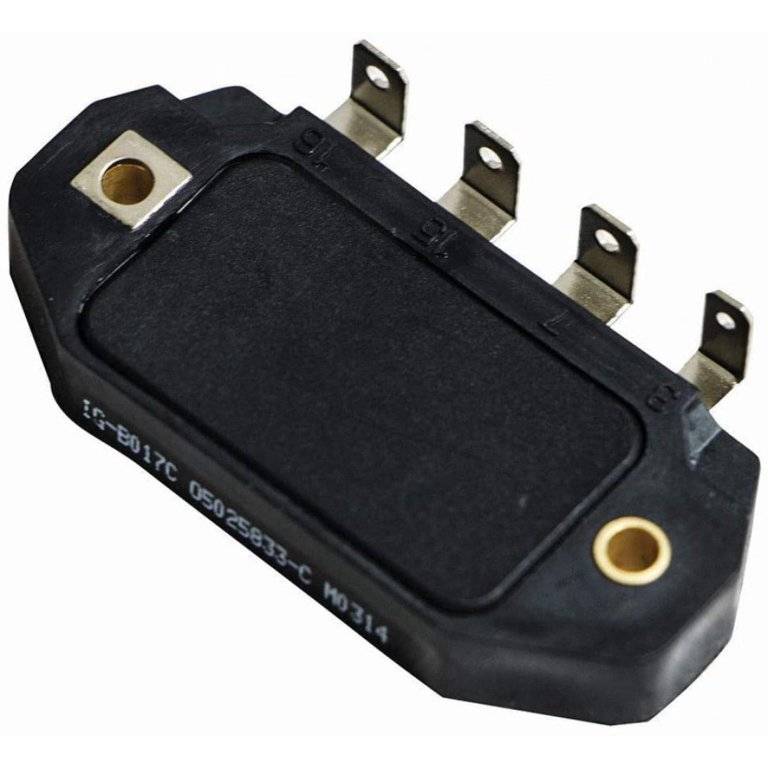

Which distributor was it that you used, and what else did you have to order to go with it? I'm really not familiar with the HEI.
Born to be mild here, not understanding the fascination with heads that weren't made by ol Walter P.

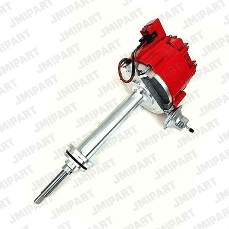

Is this one ready to run? I dont know much about HEI
Both the street distributor and the pro billet are ready to run minus a coil. I used the street distributor and the procomp e-core coil. Their street distributor uses a hall sensor style pickup and what looks like an HEI module similar to the type in the picture attached. I literally spent more time trying to get the distributor intermediate shaft adjusted for proper distributor alignment and wire routing (I'm anal about loose wires everywhere) than I did with most of the install and setting the timing. I ran a 30amp normally open relay which I mounted where my ballast resistor used to be so I could get full 12-14 volts straight to the coil. The street distributor is a 2 wire hook up direct to the coil. Simple easy install and works great so far. There has been a noticeable improvement in start up and throttle response but the old magnetic pick up style electronic distributor was worn and had some slop in the shaft.

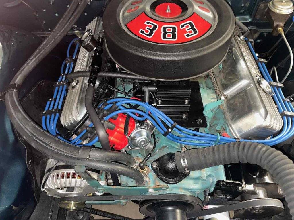

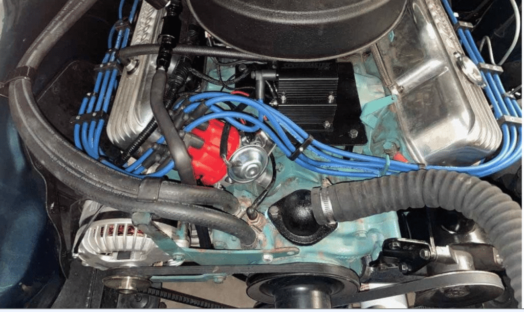

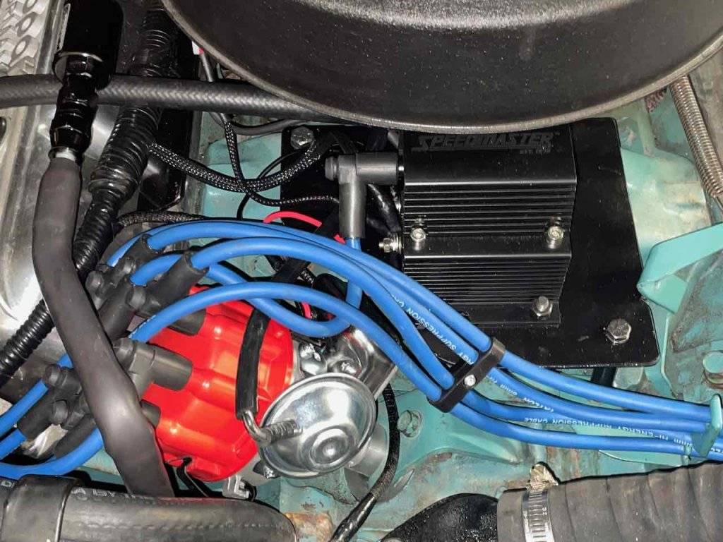

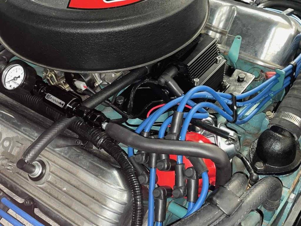

If you want another option from the petronix, although totally sacrilegious, I'm playing with converting mine to HEI ignition with an e-core coil. I'm having a couple aluminum mounting brackets made for everything and can send pics hopefully after this weekend. I know there's the guy who makes a bracket that mounts the module under the factory magnetic pickup but I wanted to keep it away from the engine heat and also not just throw it on the firewall or something. In actuality you won't even know it has HEI by looking at it other than the E-core coil drawing questions because I gutted an old mopar electronic ignition module and wired it through the oe terminals that go thru that harness. Even soldered a jumper wire in the ballast resistor and removed the resistor portion from the back of the ceramic portion. I will have to run it here in the AZ heat to make sure the module cools properly the way I made it. I know some will ask why but my answer is always just to see if I could and to keep people guessing at things when I pop the hood.
