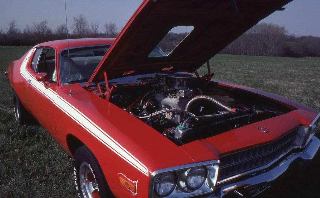

    Installed this on my '66 Newport with a warmed over 383. It runs great and definitely gets attention when I pop the hood.
    A max wedge would be cool as heck, but uber expensive as you need the matches heads etc. to make everything work correctly.

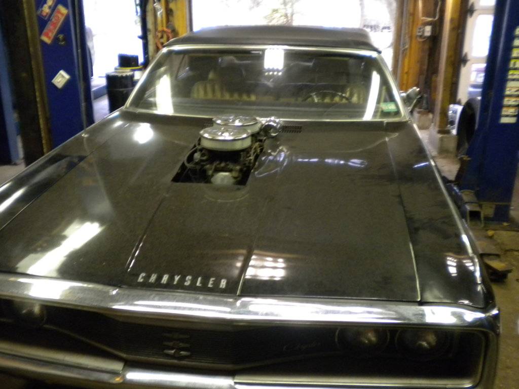

    I put a Tunnel Ram on my 65 Fury convertible. It was originally just for kicks. I liked it so much, I kept it on. I am running a manual valve body transmission. If you are running a stock automatic, you will likely need to switch to a cable style kickdown linkage to make the setup easier. I am amazed at how well this thing runs on the street. At the track, it just could NOT get any traction (it was marginal before). You will definitely get some serious looks.

    i put a tunnel ram on '69 newport convertible. that 440 will use everything i can give it. all eight barrels. actually does run good. afb's are a cinch to tune. cool part is the intake noise wide open is about as loud as the exhaust. still wish i hadn't done it. makes far more sense on '65 fury. newport 009.JPG the dust gives an idea of how often it's driven.

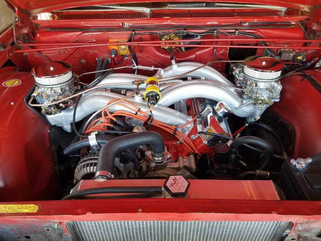

    If you want it to look cool when you pop the hood, go with a Max Wedge cross ram reproduction for stock port heads. You can run Eddy or the small TF or Stealths. Will look cool, run almost as hard as a good single quad, and not require a huge investment in other expensive parts.

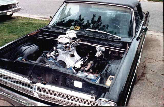

    This is what is going to replace the tunnel ram on my 65 Fury.
    Too much is not enough....

    that poor fury's shaking at the sight of it. you'd catch hemi car now! any details on the rest of the drivetrain?

    Race built 727 manual shift automatic, 3200 rpm B&M converter. 3.91 sure grip 8 3/4. Frame connectors, heavy duty leaf springs, poly bushings. I have TTI long tube headers for it as well. Engine has Stealth heads, steel main caps with stud girdle. 9:1 blower pistons. I haven't picked a cam for it yet. It's got a pair of Demon 750 blower carbs also. I'm probably forgetting something.
    The blower build has sort of been on standby while I work on my 65 Belvedere drag car (it's replacing the Fury for racing). The Belvedere is taking a different tack entirely. Basically a Super Stock 'clone' but with a twist. I built a wicked slant six for it.
