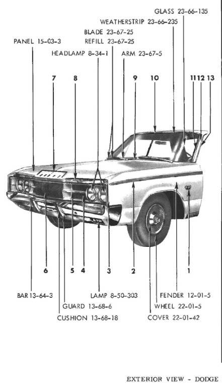

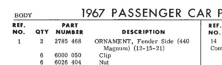

Per the 1967 parts book the Dodges should have the emblem if so equipped but it was not a common option. There are probably many more that have added 440's than ever came that way from the factory.
Thank you for that! I don't suppose that book happens to show proper placement of said emblem like measurements etc?
Parts books don't give that info, that would be on an engineering drawing that's probably lost to time. Incidentally the parts books are not necessarily an end-all, there very likely could have been some that came without the emblem depending on build date & plant. If one came without the emblem I wouldn't bother adding it.
