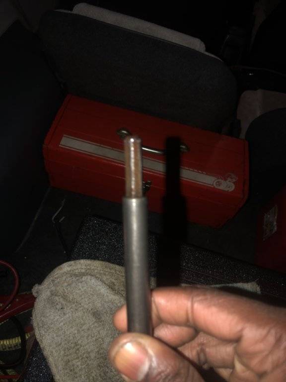

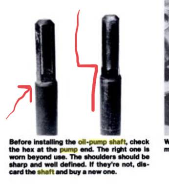

    You just want a good high speed drill that can turn that tool. You want to copy the 2000 rpm break in oil procedure that’s all. With that tool and a high speed drill - going in the right direction Lol!!! I think backwards lifts the gear out. Watch the oil pressure gauge and keep it up until oil gets everywhere. Pull a valve cover to confirm the top end but I’ve only ever really worried about the camshaft.

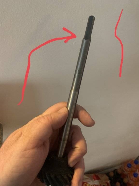

    What type of pump drive shaft you got? Nows the time to buy some cheep insurance and get a shaft with the rounded shoulder. I don’t own the sharp edge type so I stole an example off the net. The rounded shoulder is less apt to twist or twist/snap off. Dave can weigh in here but the pics should speak for themselves.
    Good luck man. Sounds like fun I love fire up days !!!!
    Ignore that text. Sorry it should say if your pump drive end looks like this throw them both away Lol!!! That text muddies the water and my fault for not taking it off bud.
    FYI this is off my TA 340 not big block just a good example of the rounded end. It’s been on the kitchen counter as a paper weight for 11 years Lol!!!

    The performance drive shaft is overkill for a stock oil pump, it is also cheap insurance. Not only is the hex sharp edges removed but the area is heat treated, and the gear is pinned on the shaft. Your call.
