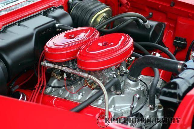

I didn't even think about that being a Poly motor!
Hmmm.... I'd be really tempted to leave that in place and work with it... Yea, no replacement for displacement etc. but the Poly motor has some good things going for it.
Just for giving you something to think about...

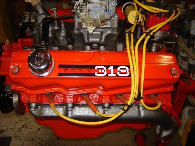

Thank you for this. I'm a little ashamed to admit that I was unsure if I even had a poly but based on what everyone is saying I think I'll be sticking with what I've got.
Easy 318 Poly ID... Valve covers will look like this and the distributor is in the back.
Edit: Corrected
