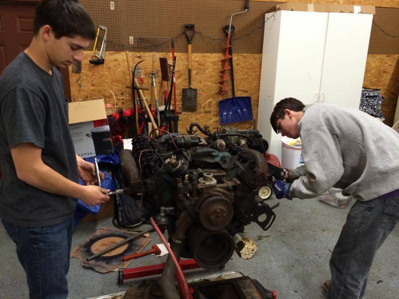

Never, EVER, mix gardening with rebuilding engines!!!
Damn you, Ross. WTH were you thinking?
Posted via Topify on Android
Yes we're trying to do that - but still not much confidence on the whole reassembly part.
Actually, I feel really good about it since I took lots of pictures & I have a great book that I bought at Jegs. I don't recall the name & don't have it here but a few others here have the same book & will know the name.

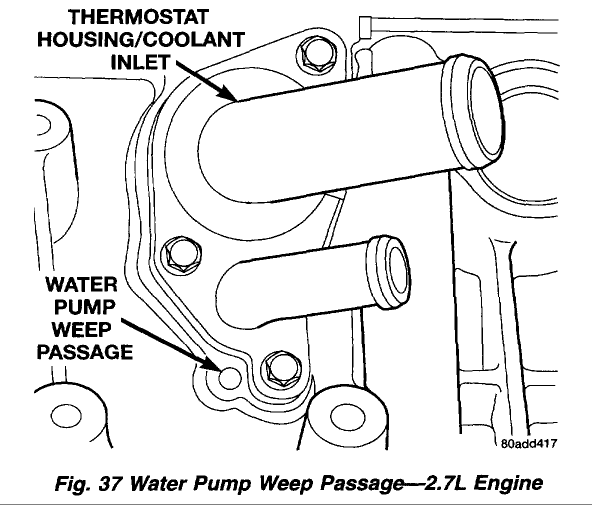

The gaskets look nothing alike. What the heck are all the holes for on the one for the later models?
I feel your pain - we're tearing down a 440 right now...

Stan, here's the reason Chrysler went to the uni-fit thermostat gasket....to fit all the other metric crap that they were making. This POS gasket will work with our BB's but I would go with the 1969 FelPro 35063 gasket.
The thermostat housing was a larger in diameter pre 69. The later ones were smaller. My 68 uses the 35063 gasket. Its even a different thermostat part number for the later engines.
