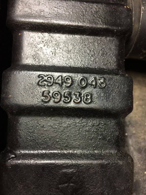

Is this the correct radiator for my 68 300.

2898066 is 28 inch wide 68 440 with A/C(I believe this is Imperial)
2898063 is 22 inch wide 383 or 440 no A/C
2898 072 is the 26 inch wide 440 with A/C
