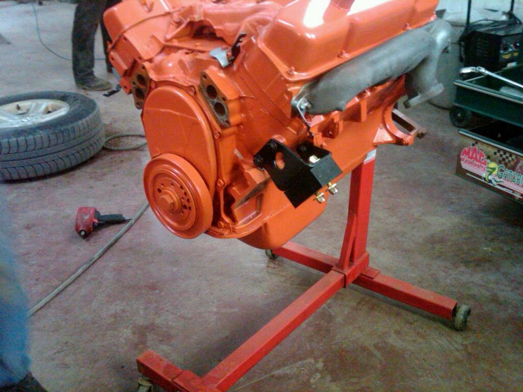

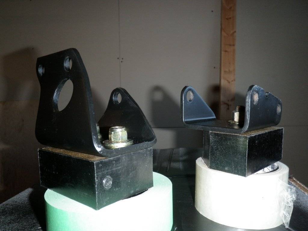

  5. 300rag
    300rag Old Man with a Hat
    My Photo Garage
    Messages:
    7,837
    Likes Received:
    6,438
    Joined:
    Dec 4, 2010
    Location:
    Carstairs, Alberta, Canada
    Like this...

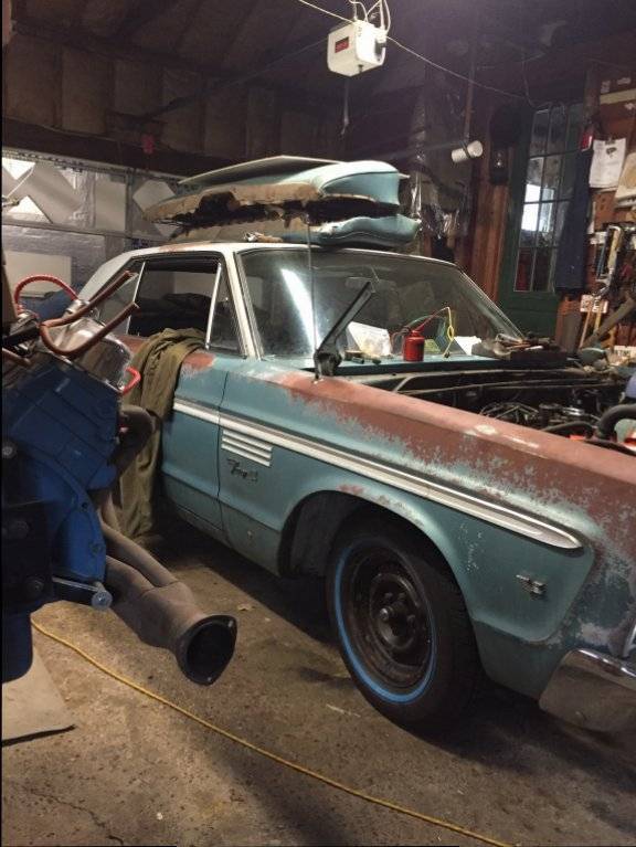

    300 rag, you have provided me with some awesome information. After reading these posts, and being a new member, my motivation to do this project is over flowing! Where did you find those motor mounts? I am so glad that I signed up on this forum. I will enclose a picture of my project as we sit in the garage at this time. She is a solid West Virginia car that I found in western New York behind a garage. $1000, and I thought I got a super deal.!
