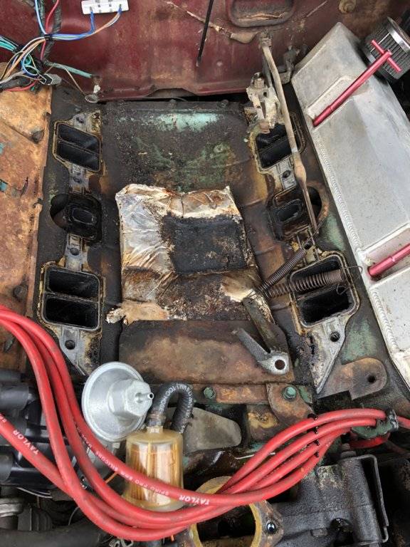

    on inspection of taking off the valley pan on my 440, I saw no traces of any type of sealant. The instructions that came with the new valley pan from fel-pro say to add a sealant at the four corners. Is this advisable or should it go back stock and dry?
    Also there was this piece of insulation between the valley pan and the intake. Should I find something to replace this? If so any suggestions?

    The insulation is sound deadening material to help quite the noise from the lower part of the valve train. You can safely discard that item. The factory metal shim used no sealant. If you have bright shiny metal at the sealing surfaces, you probably won't need any. Caveat: if there is any rust present that has resulted it pitting of the sealing surface, then you should use a light coating of aircraft grade Permetex. The corners under the mounting strip at the foreground of your photo would sometime weep oil, you will not hurt a thing by adding sealant there. All this assumes that you are re-installing the factory cast manifold. After market aluminum manifolds require the use of paper gaskets on the intake ports. Be sure to use you shop vac to clean up as much debris as possible so all that crap does not fall into the valley.

    I wouldn't say its bright shiny metal but its not pitted either. I would rather be safe than sorry so i may add the sealant. Should I put a light coating over all the mating surfaces, just corners or all along the front and back?

    If it is not pitted, you probably do not need it, but a light coating will not hurt anything either. Be sure to torque the manifold bolts per the FSM, most leaks are the result of bolts that are too tight or too loose.
