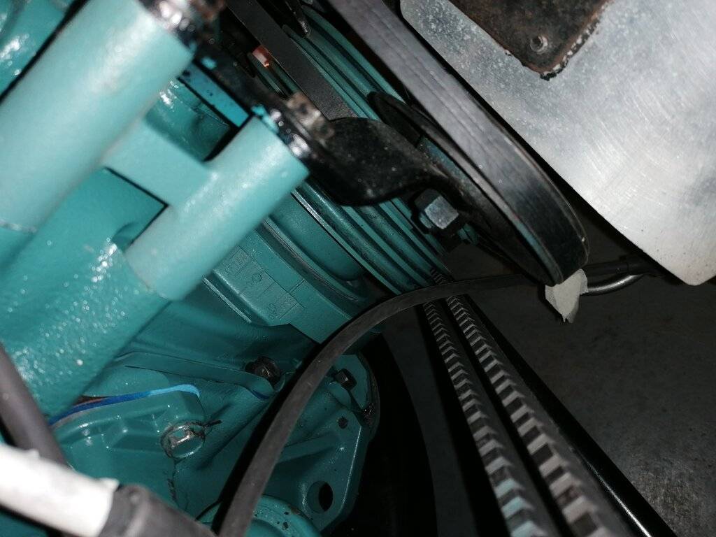

can you post a pic of the timing mark in relation to the timing gauge?

If lacking a compression gauge, you can remove #1 spark plug and have an assistant hand crank the engine, clockwise as you face the front of it. Put your finger over the spark plug hole. You will feel pressure on the compression stroke and nothing on the exhaust stroke. Stick a piece of coathanger down into the cylinder 1 once you have ID'd compression stroke. As your assistant hand cranks engine, you will feel a pause at TDC. Stop your assistant. Turn the crank counter clockwise until the mark is at 10°BTDC, like @saylor picture. That should get you started. provided your spark plug order is counter clockwise as you face top of distributor 1-8-4-3-6-5-7-2. Idle crews on carb can be about 1.5 turns out. Good luck.

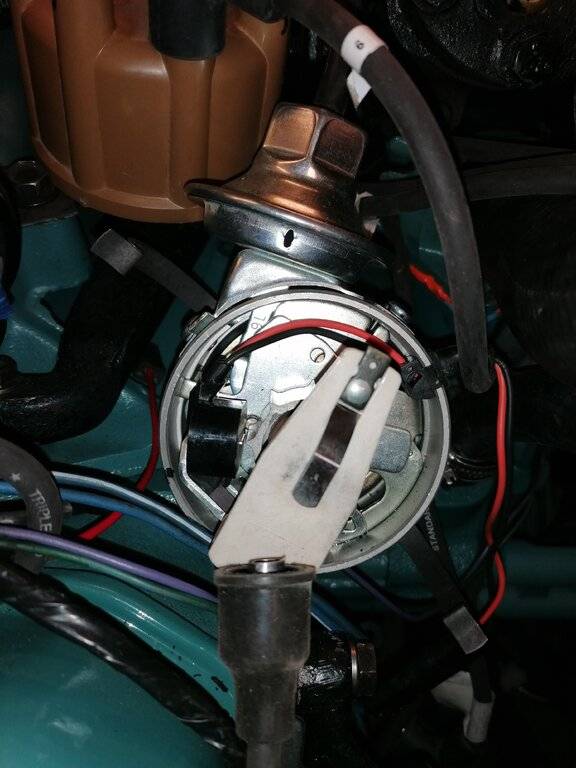

The distributor looks like this at 10-12 BTDC. I've spun up the oil pressure, thank you for your consideration.
Either you're currently set near TDC on the exhaust stroke, or someone has disturbed the way the wires are plugged in on the distributor cap. You have to locate where the #1 wire is plugged in on the distributor cap, and make sure the rotor (metal end) points to that on the Compression stroke.
#1 cylinder is the one all the way at the front of the car on the driver's side.
It appears to me that the distributor gear is not in its proper place. Like was mentioned in post 10, the slot in the top of the gear running the distributor should be running parallel with the engine. That puts #1 plug wire and the rotor at 6 o'clock when standing in front of the engine. Providing the engine is at top dead center minus 10 degrees. In pic 12 it looks like the rotor is a couple cogs too far counter clockwise. (pointing at 1 o'clock in the pic) Rotor should be between 5 and 6 o'clock in that pic. You need to pull the distributor and walk that gear around counterclockwise until it is parallel. Then check your plug wires to see if the firing order is correct.
Or: You could change all your wires starting with #1 plug wire at 1 o'clock (where the rotor points to now) then plug them in to the correct firing order if you don't want to rotate the gear to the proper place.

see that pic above ^^ cyl#1 is over 7-8 oclock your rotor firing end should be over there somewhere.
