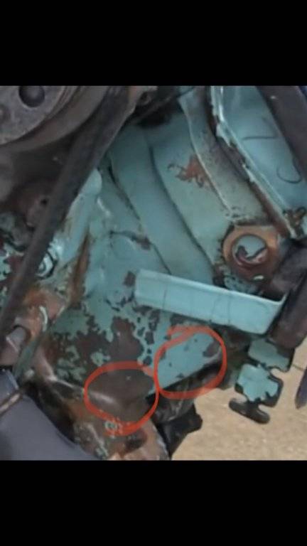

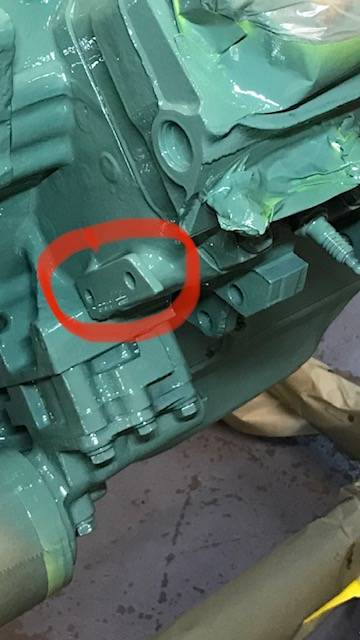

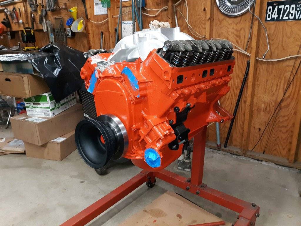

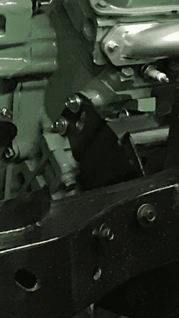

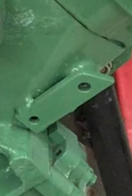

My '65 Sport Fury needs the left side engine mount to come off the front of the block. The '69 440 I have would have needed to be modified more than the '74 440. The '74 had the bumps on the front of the block, but they were short and had to have a 1/4 thick piece of steel added as well as the holes drilled and tapped for the bolts. The first picture shows a screen shot of a 440 I found online without the provisions for the mount. This is like my '69 440. The second and third pictures are of my '74 block after the added steel, drilled and tapped. The fourth picture is with the mount bolted in the frame. Check the mount on your car, I think our sub-frames are interchangeable, if that's the case, you'll need the provisions for this mount. The steering box is in the way of the more common mount.

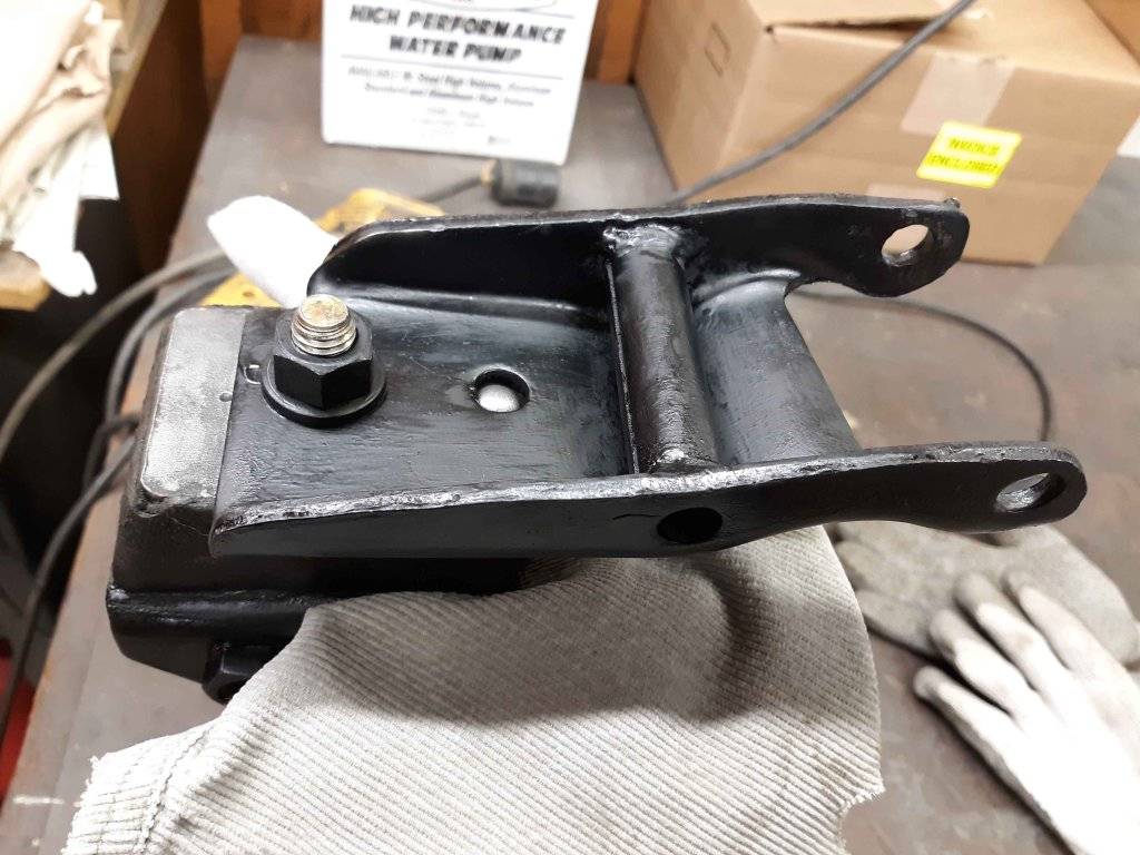

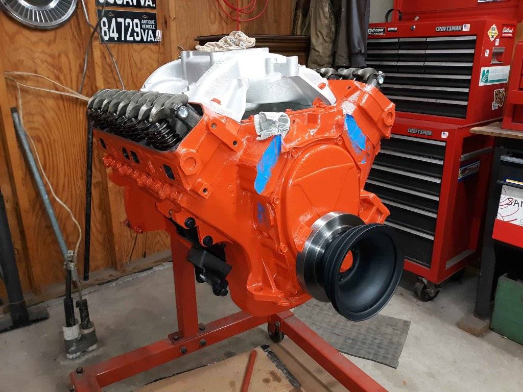

Of course, there is the motor mount and then there's the bracket that attaches it to the side of the engine block.
You can probably get motor mounts locally, although big block engines went out of production in 1979. You may have to special order them.
If you don't have big block motor mount brackets, you cannot order them locally. I'd place a want ad on FCBO.
Installing motor mount on bracket in a vise
Left side big block mount
Motor mounts installed on the 440 and awaiting installation on my 1970 Fury Convertible.

My '65 Sport Fury needs the left side engine mount to come off the front of the block. .... Check the mount on your car, I think our sub-frames are interchangeable, if that's the case, you'll need the provisions for this mount. The steering box is in the way of the more common mount.
