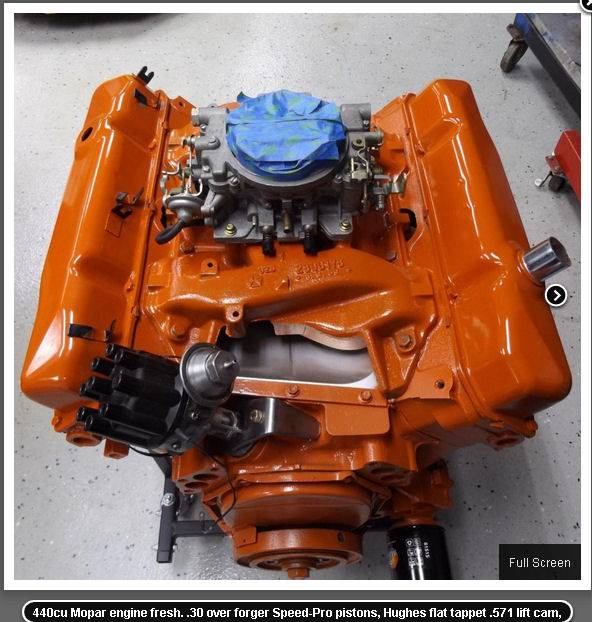

I purchased a Hotted up early MAGNUM 440 motor to put into my 1976 New Yorker.
Problem is ..... the early version did not run Power Steering or Air Conditioning ! My Later block facilitates these options with "Nuts" etc welded into the Block and (facing) Right-Hand Head so that the Bracketry can be mounted to support said extra's !!!

After looking at your engine picture . . . IF it's got a .571" lift cam, you WILL need to probably change the torque converter AND rear axle ratio in order to use such a wild cam on the street, for anything close to "daily" use. Which can make the search for accessory mounts the least of your worries, by observation.

Motor is built to be 500Hp at the rear wheels. Knowing I was doing this, a 650Hp capable new Trans with 1850RPM Stall was already fitted, at the same time, + the Tail-Shaft was uprated to cope. I have purchased a set of 3,55 gears for the rear end, but they are wrong, and do not fit my Diff, so taking it easy whilst running it in, and locate the correct parts. I have everything bolted up bar the new A/C Pump, and localised fabrication is looking like the go. Car is ex-One Owner, 50k miles and immaculate head to toe (scored it right under your noses off eBay for $5k) .... it is my daily driver .... and turns heads here in Australia .... I TELL YA !!! lol
