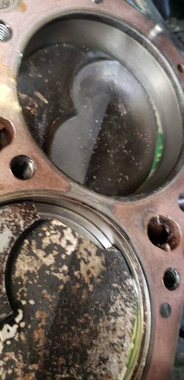

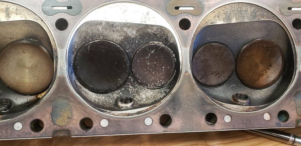

    Well my much troubled 451 ended its career two weeks ago. Got on the freeway, and she began misfiring. Looked in the mirror and I couldn't see behind me the coolant was going out the exhaust so bad. Wrecker ride to the garage where I get it worked on. After sitting a day, the oil became overfull. Pulled the heads and found what you see in the pics:
    From what we can tell so far, I broke a piston and in turn broke the block. Consulted a good machine shop, and will have the heads inspected for reuse. Owner looked at pics and knew right away what happened. The ring gap on the top rings was insufficient for a Keith Black piston, and it expanded and broke out the ring land you see in the pic. A year ago, when I broke one of my built iron heads we'd found that one of the rods hadn't been resized and the bearing was getting ready to spin. We rectified that With new bearings and resizing of the rod, but even then on start up I had to crank for a few seconds before I activated the choke so that you wouldn't hear rod slap on start up. In addition, the engine always made a "wah wah wah wah" sound until it was completely warmed up. In short, my machinist was a crook stealing from his business, his customers, and doing shoddy work. I got screwed. So now here I am with really bad choices. I can sleeve the bad bore, and have a new shop check all the clearances and fix whatever is still screwed. Or, I can put a low mile RV 440 in, utilize the 440 Source heads, my oil pump, water pump, and XE268H Comp cam and runs that. That's probably my best choice as I don't trust that 400 block anymore, but compared to the 451 this 440 will be a slug. Last option, walk away from the car and sell it for whatever I can get for it. I can't afford to rebuild engines once a year. This sucks.

    Where are you located? Probably safer to salvage what you can and get a new engine or new block.

    If the rv 440 is complete I would run it that way. They are low perf but run great on shit gas. Adding heads will not likely do much. Unless you add a turbo! Then of course you need proper ring end gap for that too.
    I wouldn't hesitate to sleeve it and buy one piston.
    But my advise is questionable. If I had a forged piston with that damage I wouldn't be able to resist welding it up and re cutting the ring groove. If that worked.. I would have to try it out.

    You will never be happy with that RV engine till it comes apart. Compression will be in the toilet, not just low. Quench and advantages of the aluminum heads will be negated by pistons so far down in the bore you will get a echo. IMO stay with combo you already own, I would sleeve it and correct any "errors" from previous build. Is this the same piston that suffered from the leak in the iron heads?

    You are lucky that the parts that broke off the damaged piston did not take out the head. Be sure to pull the valves from that cylinder and check the seats for damage from debris that went out the exhaust. Does the bore have a hole in it or has it cracked? A hole is usually more reliably repaired with a repair liner than a crack because a crack expands the size of the bore and that can cause problems getting a tight leak proof seal on the repair liner and cracks tend to keep growing. If this was the same cylinder that failed with the iron heads, the piston may have had microscopic damage (cracks) that caused it to fail after the heads were replaced. I agree with you evaluation about this engine not being trustworthy. If you still want a 451, I would start with a fresh block. That of course means a fresh build and it probably would make more sense to start with a 440. You can toss the truck rotating assembly in favor of an after market high tensile steel setup on the crank and rods that will be much stronger and much more reliable on a performance build. If that is not financially feasible at this time, install the truck block and run it as is until you acquire the funds to start over. You will have a low performance setup with the RV engine, but you will have the vehicle mobile.

    You had really, really ported iron heads and they cracked, that what they do. That's why really ragged edge iron heads are drag race only pieces. Second failure is wrong ring gap, no other explaination for broken piston at normal rpms. I know you don't trust the block and now it has major problems with the crack/hole which is from sticking the piston in the bore.
    If you can't hear the RV engine run then your at a fork in the road. And your going to have to rering and bearing while you add you HP parts. Is fix my junk and not add a new block into the mix.
