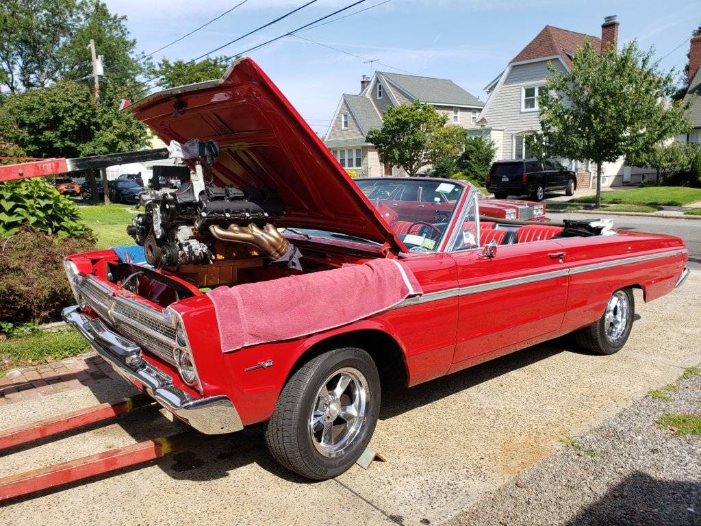

    Hello all ! Just wanted to share some pictures of the progress on my 65 Fury Hemi swap that a friend of mine and I have been working on.

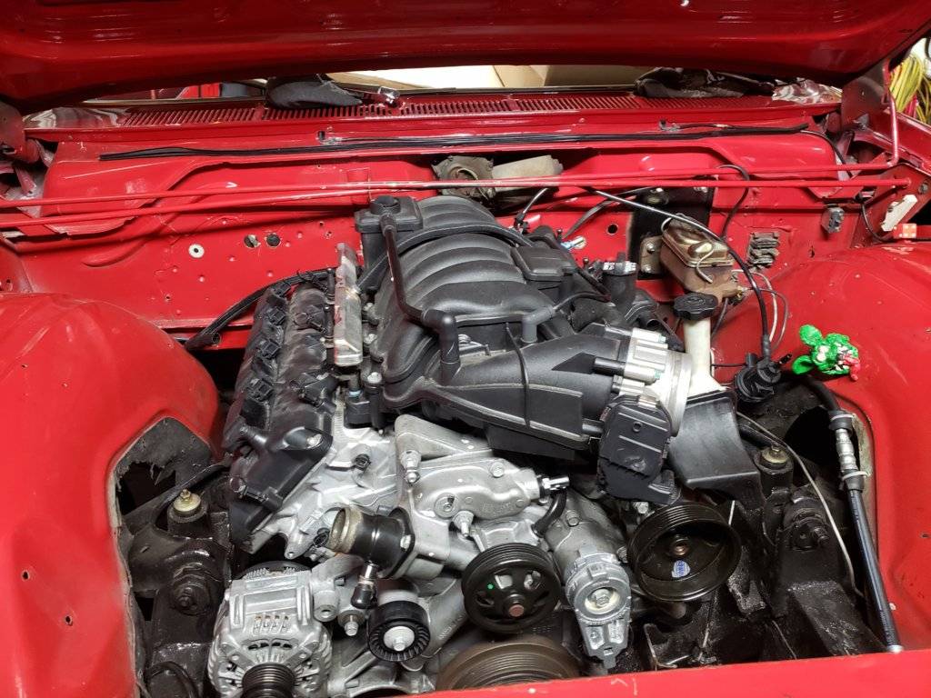

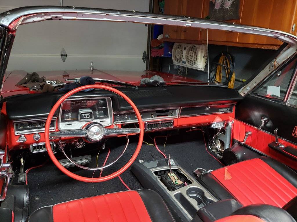

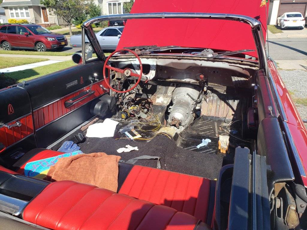

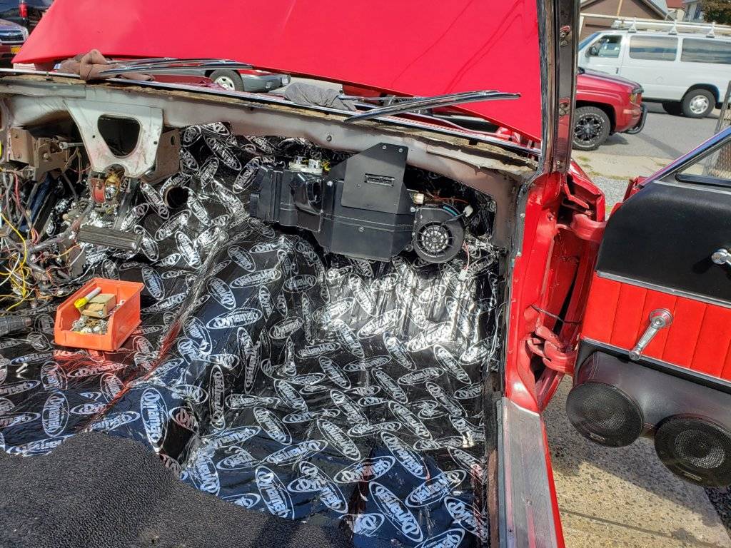

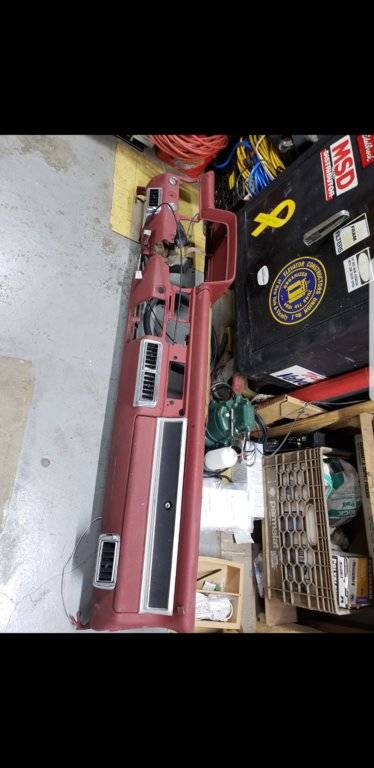

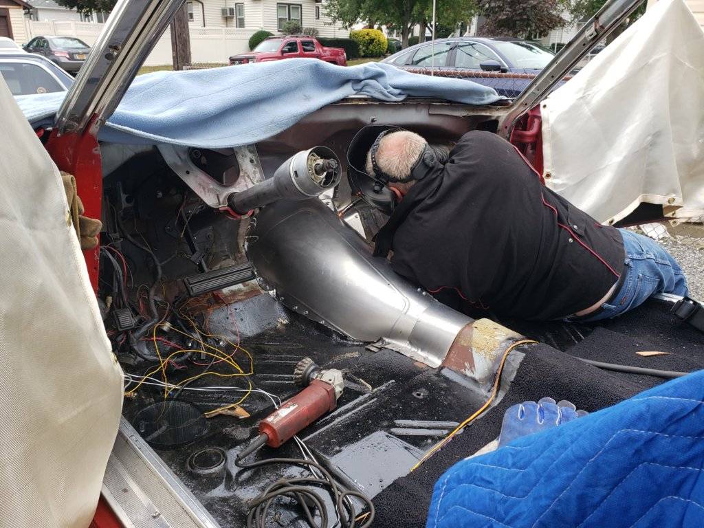

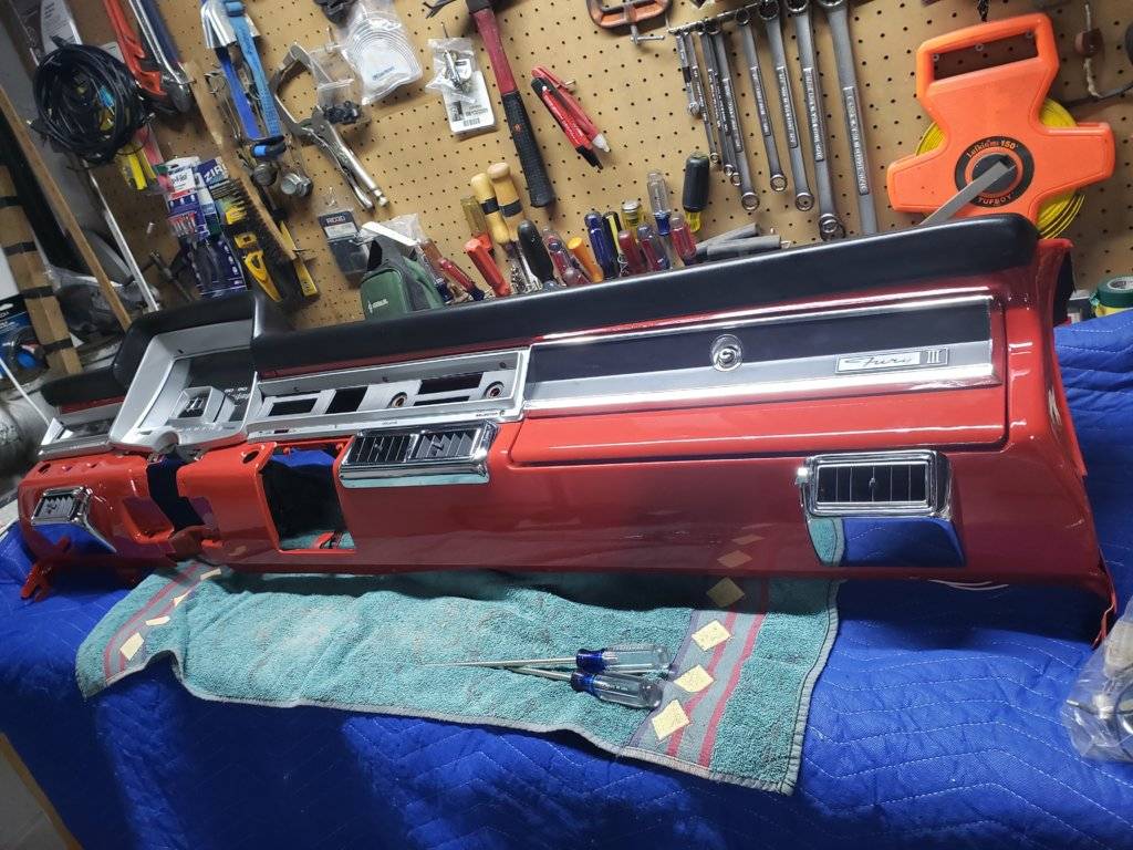

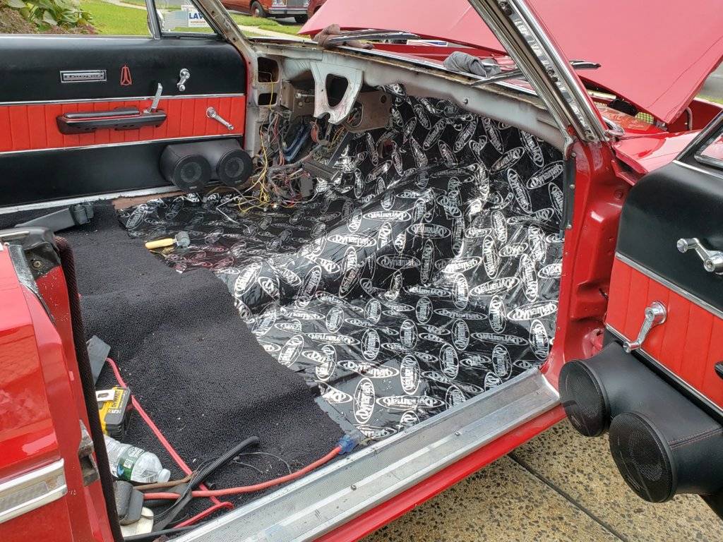

    Started with a 65 Fury convertible, and picked up a doner motor and transmission from a 2013 srt8 challenger. Since no body makes a kit for this swap, we made the mounts, and got the motor in. 20190831_104139.jpg then , we needed to make room for the Nag1 transmission. Cut the tunnel out, and altered the transmission crossmember. 20191005_125848.jpg I bought a universal transmission tunnel kit from chassis engineering, cut it to fit, and welded it in. 20191006_093111.jpg lined the inner firewall, and floors with dynamat. Hopefully, this will help to keep some of the heat out. 20191012_124410.jpg while it's all apart, I decided to go with a vintage air A/C kit 20191012_131203.jpg picked up a dashboard that has A/C from a doner car, and painted it to match the car. (Color is a little off. Red is hard to match. Lol) Screenshot_20191011-200702_Gallery.jpg 20191011_173710.jpg installed the dash, steering column, and floor shifter from the Challenger. 20191021_163459.jpg had to use a Borgeson steering box for extra clearance between the exhaust manifold and steering box. I couldn't use the headers that came in the motor. I wound up using mopar performance exhaust manifolds for a srt8 jeep. 20191005_125921.jpg that's as far as I'm at with it for now. I will post more pictures as I move along!

    What did you do to solve the alternator interference with the frame? I've seen guys notch the frame and others hack up the accessory drive.
  18. Andy Smith
    Andy Smith New Member
    Messages:
    26
    Likes Received:
    60
    Joined:
    Aug 22, 2019
    Location:
    Long island NY
    I've seen guys with that same problem. The alternator just barely clears on my Fury. I set this motor with the exhaust manifolds in place, and have clearance for the power steering box, and alternator. I shaved the mounts off of the K frame, and welded the mounts back down where the motor has the most clearance. 20191003_124452.jpg

    That's a stroke of luck then! Can you speak to roughly how much the nag1 interfered with the stock tunnel for proper driveline angle? I just picked up a core 5.7/nag1 for eventual fab work on my 70.
    • Like Like x 1
  20. Andy Smith
    Messages:
    26
    Likes Received:
    60
    Joined:
    Aug 22, 2019
    Location:
    Long island NY
    I will take a stroke of luck anyday! LOL I did change the oil pan to a center sump, and that probably helped the final location of the motor. A rear sump oil pan would have made the alternator hit the upper control arm because the motor would need to be further back to clear the K frame. The center sump pan let me move the motor towards the front of the car, clearing the passenger side control arm.
    The Nag1 is a stubby, but beefy transmission. I tried to get it In the tunnel with slight mods, but the top of the transmission was just too tall . I did use the factory transmission mount and bolted it to the slightly altered crossmember. I had to cut the entire tunnel out, and after the nag1 was in place, i bought a universal tunnel kit , and welded that back into place. I still haven't had a driveshaft made yet. Just started making an exhaust, then probably the fuel system will be next.
