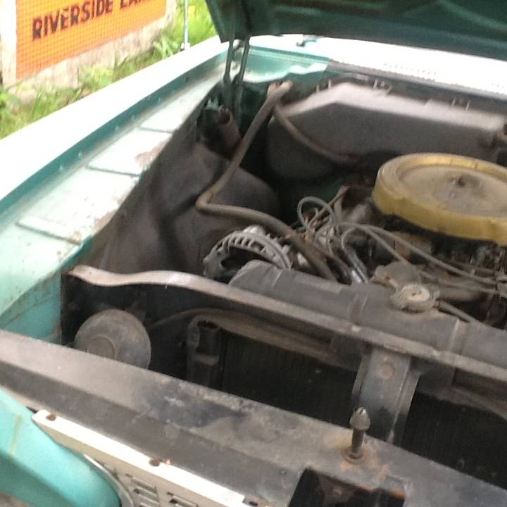

Yes LA built is black fender wells. That’s a 5 in the fourth digit of the VIN
Here are a few examples of what I'm talking about.
61 ply green ext black inner fenders,firewall,radiator support.

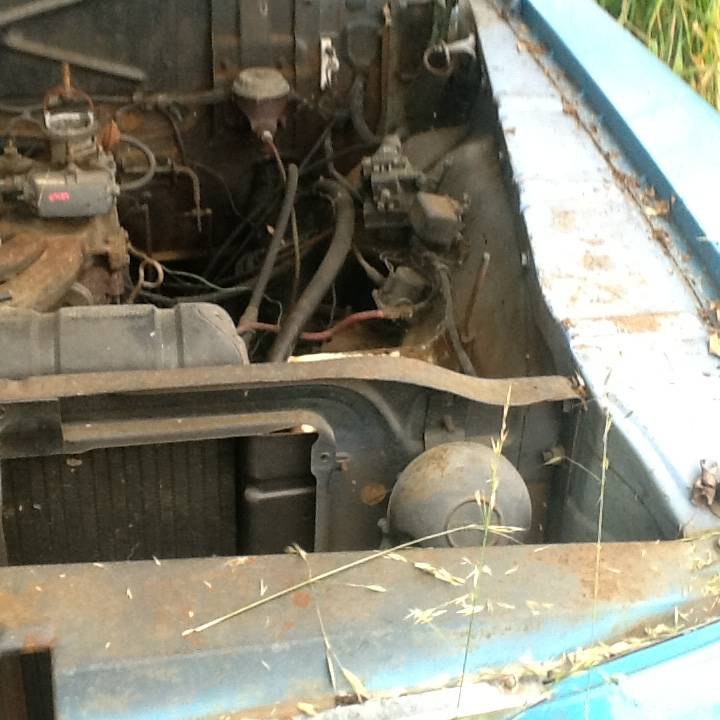

61 ply blue ext. black inner fenders,firewall,radiator support

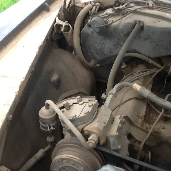

61 ply tan ext black inner fenders,radiator support, Tan firewall

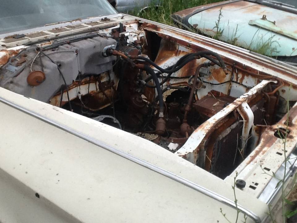

61 Newport ext white White inner fenders,firewall,radiator support

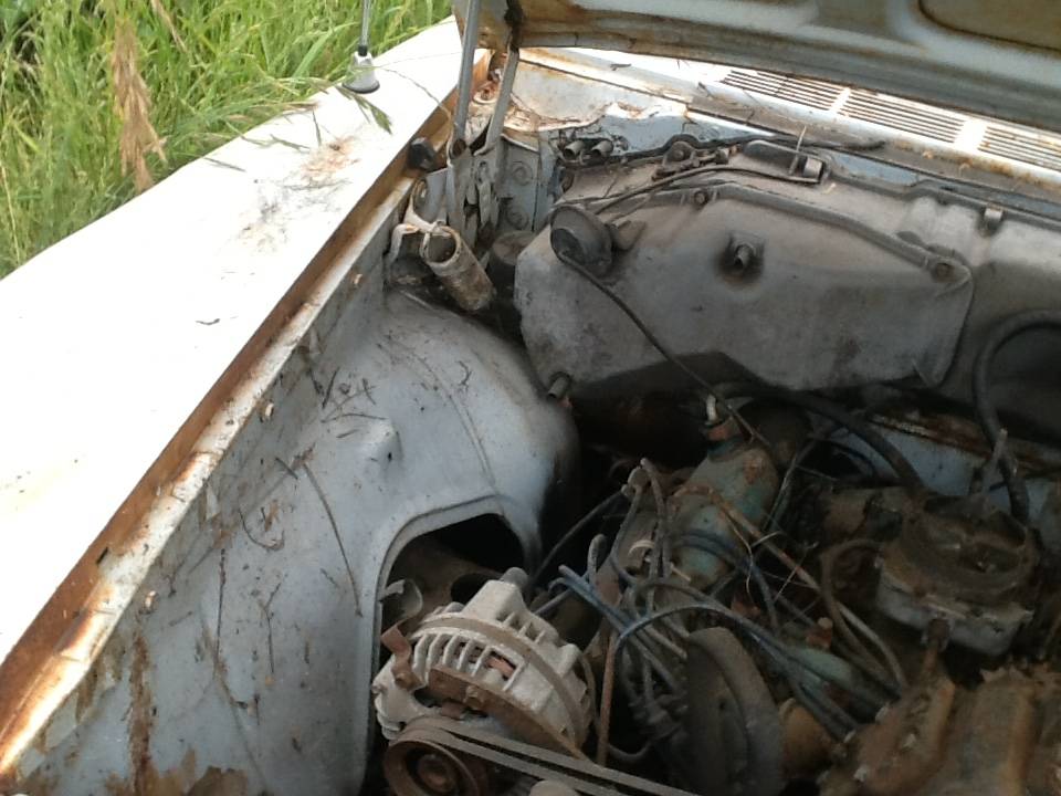

63 300. ext white White inner fender,firewall,radiator support

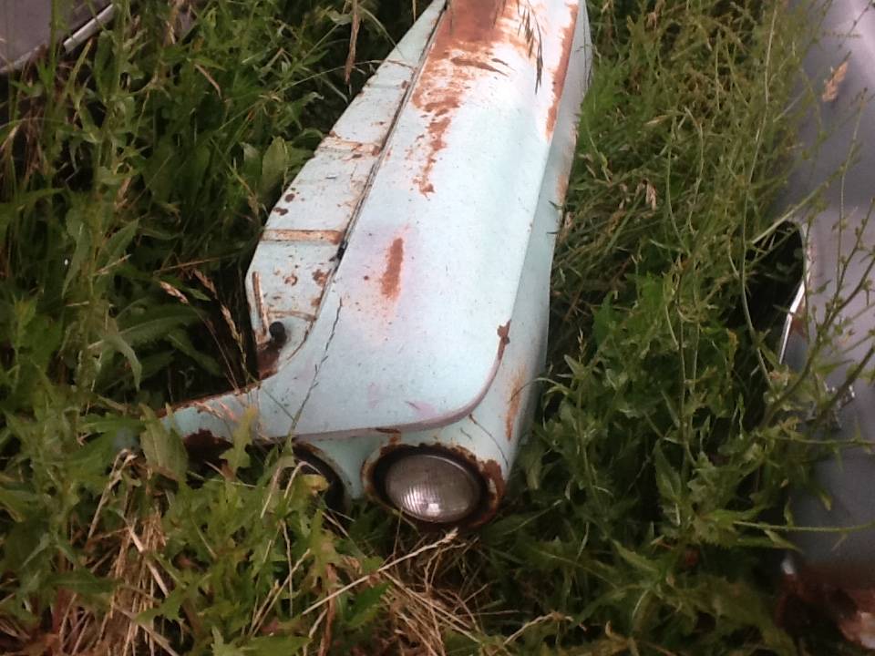

61 ply turquoise fender, black inner fender
