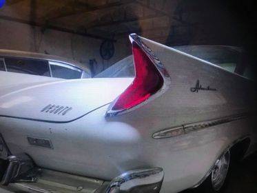

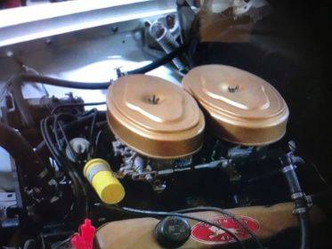

Hi. I am researching an adventurer a friend owns. Were these cross rams from factory? 383? His is 413 with dual quads in line. I think his engine is from a later car.....?
Looks like the factory 2x4 set-up. I suspect the cross-rams were Chrysler 300 Letter Car items only? The Letter Cars had to be the most powerful, as a "pecking order" sort of thing. Google can be your friend in this venture.
CBODY67
Update -- A 7 page section on 1960 DeSotos at www.wildaboutcars.com does mention and illustrate the 2x4 crossram set as the "Ram Charge" engine option.
Chrysler’s were the only car with a 413 in 1960-1961. Those inline carbs didn’t come on a 1960 anything.
Desoto, Dodge and Plymouth’s all were available with long ram 361 and 383 engines in 1960-1961.
This Desoto would have been ram induction B engine if it was a factory dual quad. The inner fender wells don’t have the bolt in panels on them so it looks like this car was not a dual carb car originally.
Chrysler’s were the only 413 in 1960-1961. Those inline carbs didn’t come on a 1960 anything.
Desoto, Dodge and Plymouth’s all were available with long ram 361 and 383 engines in 1969 -1961.
